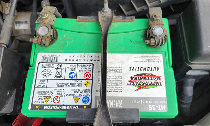

A few times in the past 2 weeks the power from the radio turned 'off' for a second and then came back 'on'. This past Saturday we were driving, at night, home on the interstate. This time when the radio went out the whole car's power went out. There was no power to the whole car for 2 or 3 seconds. (No lights in the car, no headlights, it also felt like there was no engine power) I turned off the headlights switch to 'off' and then back to 'on' and then the power came back 'on' to the whole car. It seemed fine but I pulled over to the next Rest Area. I checked the radio fuss it was fine. I checked the battery terminals and tightened the nut on the positive terminal a little bit more. The 'Check Engine" warning light has not come on nor has it ever come on during these past 2 weeks. Does anyone have an explanation for what happened? What else should I check?

This sounds like the battery has a bad connection or the battery is shorting out internally. Please go over these guides to help confirm the issue:

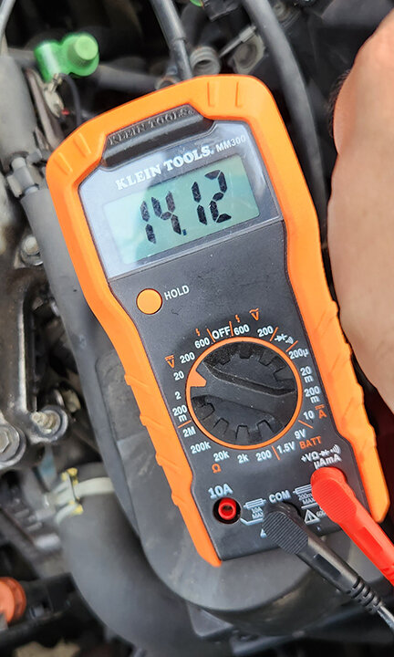

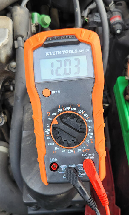

I checked the battery terminals, and I didn't see corrosion. So, I did the load test. After 15 minutes I checked the voltage of the battery. It was at 12.03. I had someone start the car as I watched the headlights, and they did not dim that much. Then I checked the voltage again. It was reading 14.12. I checked our maintenance paperwork, and the battery was replaced on 12.11.2020.

These readings are okay but if the battery is getting jostled around while driving it can short out, I would replace the battery still. Do you have a used battery you can swap in to help with the test?

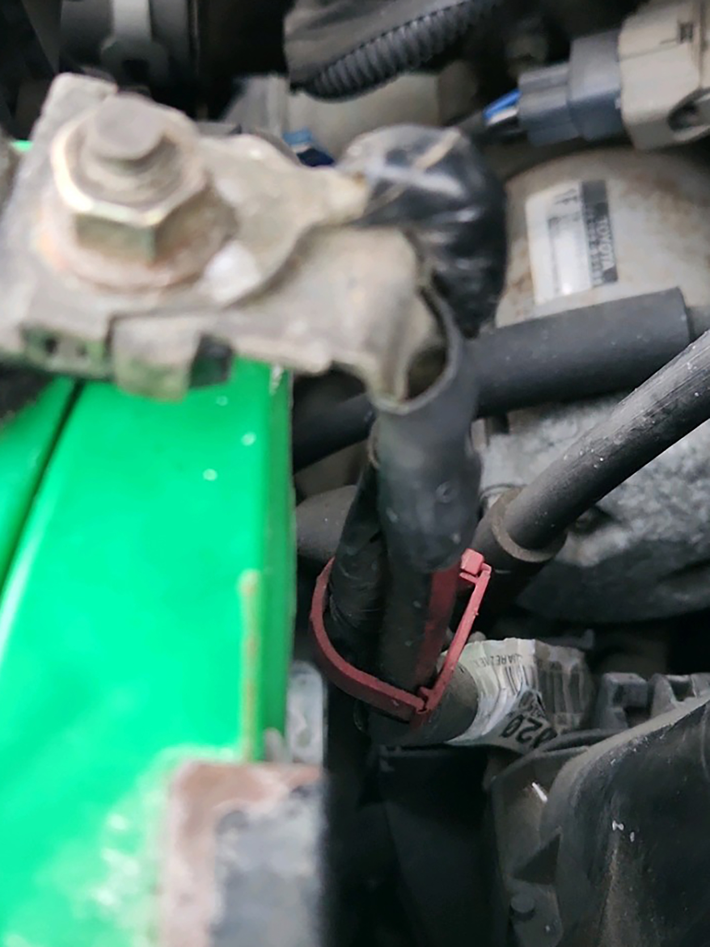

So, my son's car issue with on-and-off power loss is still happening. This past weekend, I was able to go up to my son's Uni and look at the car. Looking at the terminals and saw that the positive terminal is closing kind of crocked. So, it's not tight. I think I need to replace the terminal. Could you tell me how to figure out the gauge of the wire to the battery terminals?

It will be 1 or 2 gauge wire, can you upload an image of the problem so I can walk you through how to fix it?

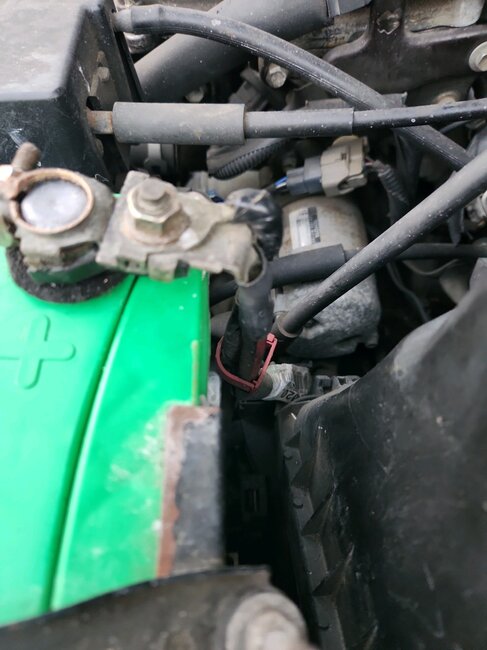

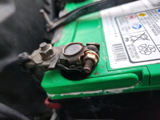

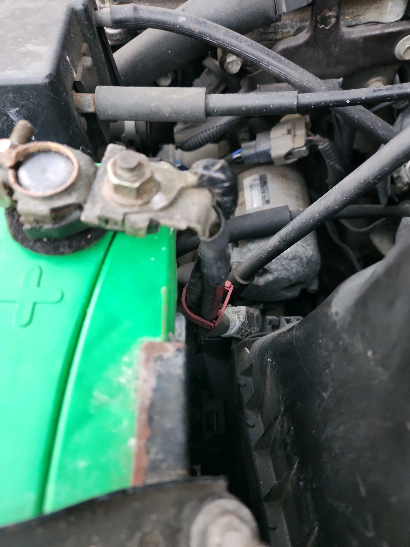

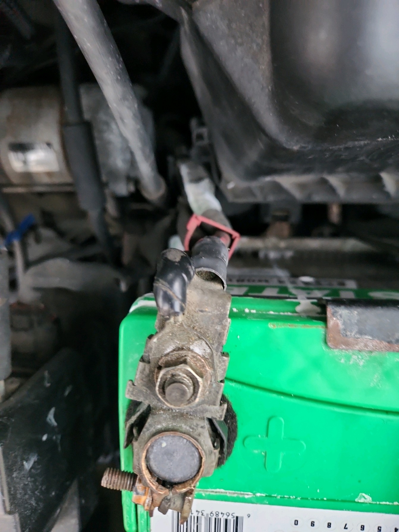

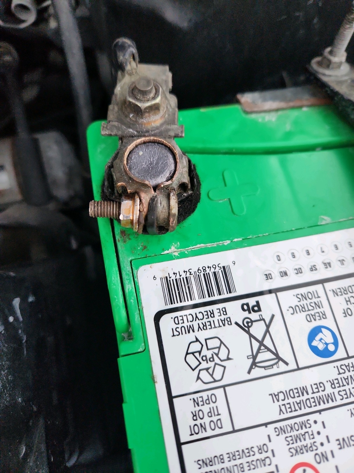

Here are images of the terminal. This is after both terminals were cleaned. The positive terminal won't tighten enough to keep the terminal from moving. When tightening the bolt (positive side) one side is closing crocked.

Looks like there are 2 cables that are connected together.

Thanks for the images, you need a battery cable end and then remove the nut from your old cable end to transfer the cable over. Here is one on Amazon for $7.00:
