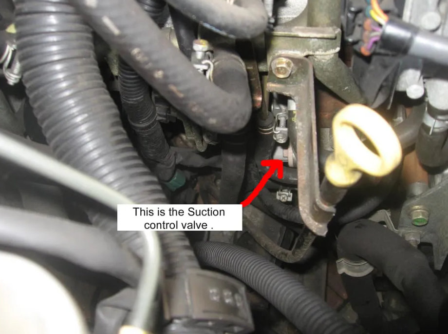

My bakkie loses power going uphill. Air filter and diesel filters have been changed but that is not the problem. What should I look for to find the problem?

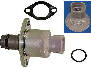

Another issue can be the SCV, suction control valve, at the rear of the high-pressure fuel pump. These can fail and cause reduced fuel pressure in the rail which in turn can cause loss of engine power. See images below
