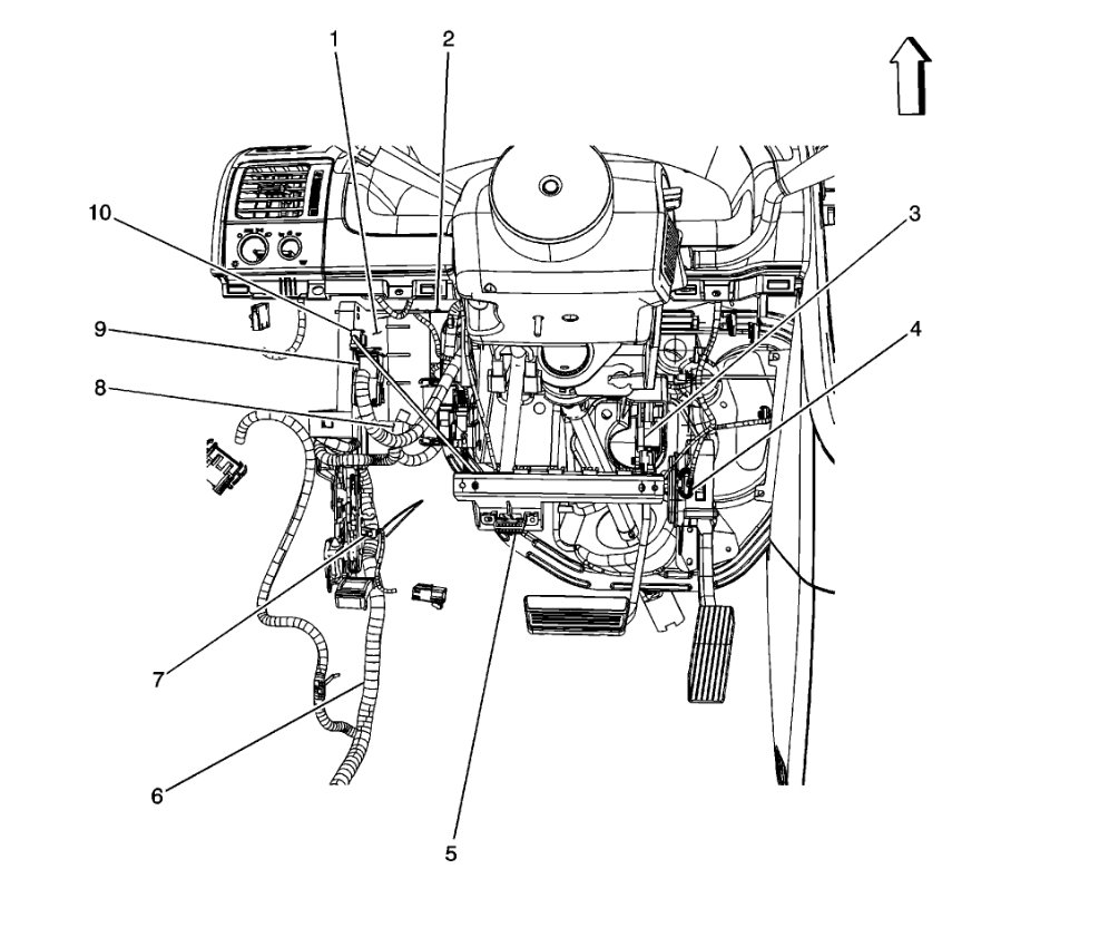

This does sound like the BCM is out but to be sure lets do a CAN scan which is the future of automotive repair you can get a CAN scanner from Amazon for about $50.00. here is a video to show you how:
https://youtu.be/InIlnsjOVFA

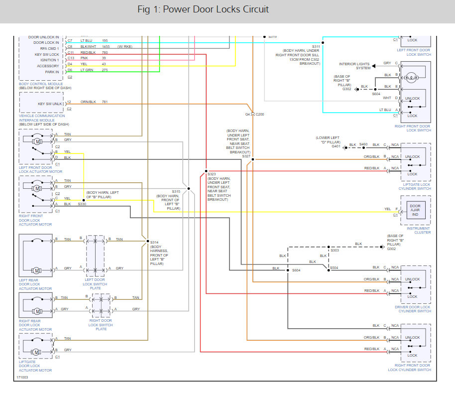

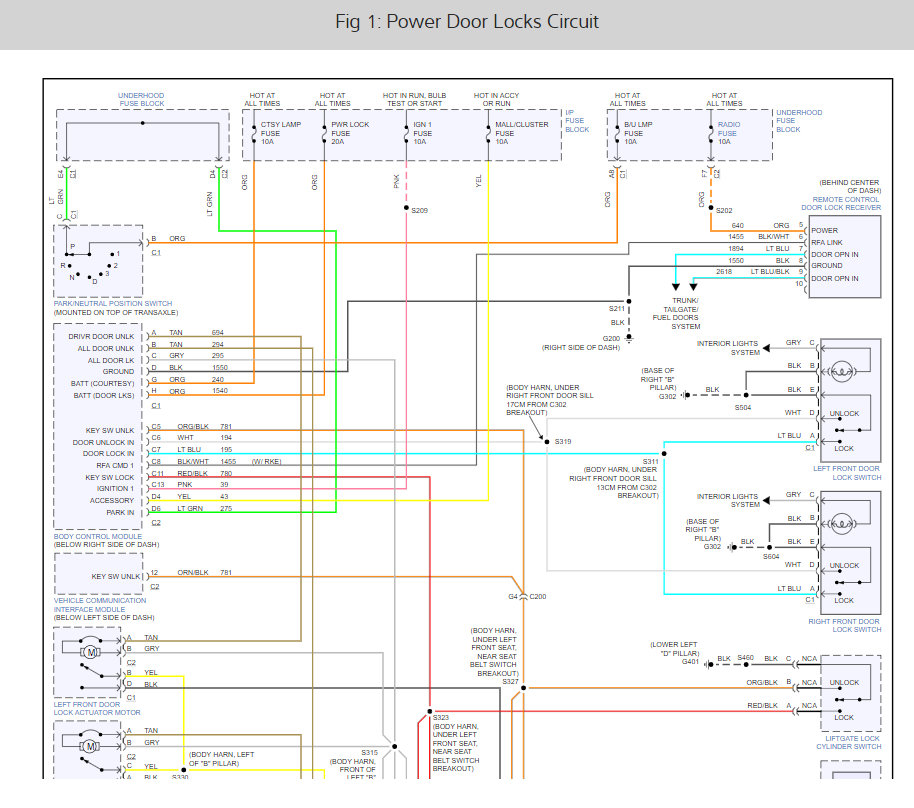

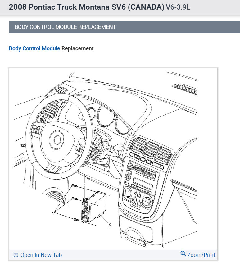

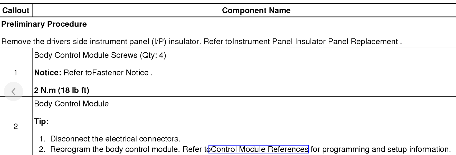

Here is the door lock wiring so you can see how the system works with instructions in the diagrams below on how to replace the BCM. Check out the diagrams (below). Please let us know what happens.
