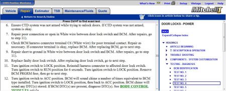

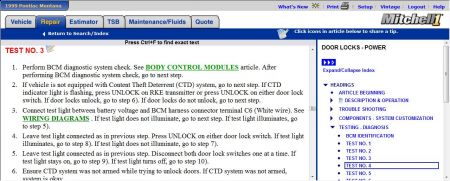

I have a pontiac montana 99 and when I try to unlock doors on driver and passerger side it will only lock it wont unlock but it will unlock wit my keyless entry I thought it was my switches so I changed them but its still doing the same thing. Can you help me pleae
Wednesday, January 27th, 2010 AT 8:38 PM
  • 75,992 POSTS
Dunno your electrical experiences but this can be a very complicated issue.I will give you a headstart don't work have the Body Control Module checked out at the dealer-below is to test a problem with the unlock circuit within the BCM
https://www.2carpros.com/forum/automotive_pictures/12900_bcm1_2.jpg
https://www.2carpros.com/forum/automotive_pictures/12900_bcm2_2.jpg
