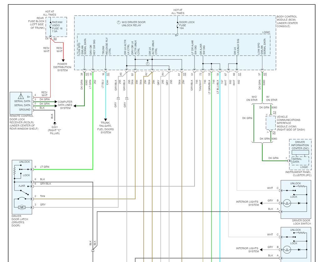

I am having an issue where the plungers on all four of my doors will move, but not move up or down to lock or unlock. Sometimes one or two will move up and down, but a lot of the time none of them do. Also, the LOCK button on the driver's door does not function. The LOCK button works on the passenger door, but not the driver's side.

This sounds like the BCM is bad but to be sure let's do a CAN scan. You can get a CAN scanner (Controller Area Network) which will work on most cars from Amazon.
https://youtu.be/u-4syLc-ifQ

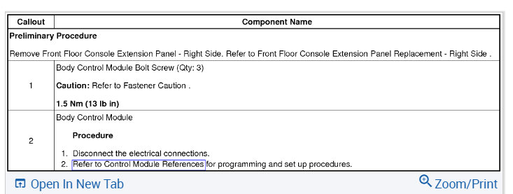

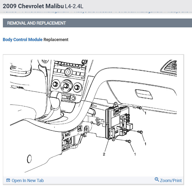

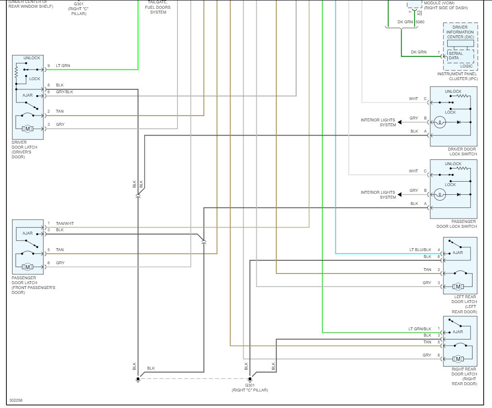

Here is how the door lock works in the door lock wiring diagrams below. Also, I have included how to change out the BCM as well, you can get a preprogrammed unit by searching Google or Ebay. Also let's check the system grounds, this guide can help:
Use the wiring diagrams to see the ground locations. Check out the images (below). Let us know what happens and please upload pictures or videos of the problem so we can see what's going on.
