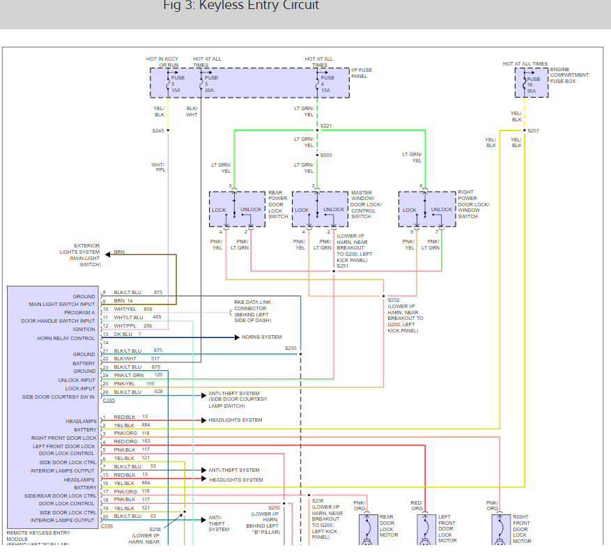

Hi, my conversion van (from Starcraft) since I own this van (three years) and always had intermittent problems with my power lock doors. Here is the problem in detail: When it is not working it is always the same, the problem is on all four doors. All the time, never had a time when only one door was not working. Something new lately, 100% not working now, and also noticed when attempting to use door lock button (ether door side) the roof light will light up! Just like if the door lock switch was the roof light switch. I made a few checks, but my knowledge is limited. Thank you for your help.

Hi and thanks for using 2CarPros.com. I have to be honest, this is a tough call for me because of the conversion. When these vehicles are converted, many changes are made to the OEM wiring design and formats, which means I cannot review the original equipment wiring schematic to help determine the issue. However, I would like to make a recommendation to you which you may find beneficial. These vehicles have a wiring harness which is located between the door frame and the door. When you open the door, you will see it located in the front section between the door and the A-pillar. Often times, the wiring in at this point is damaged from opening and closing the door. What I would like you to do is inspect the wiring at that point. To me, it sounds like the power from the main switch in the door has a wire which has been damaged and is now making contact with the interior lighting system. Hence, when you try to use the locks, power is sent to the lights rather than the lock solenoids.

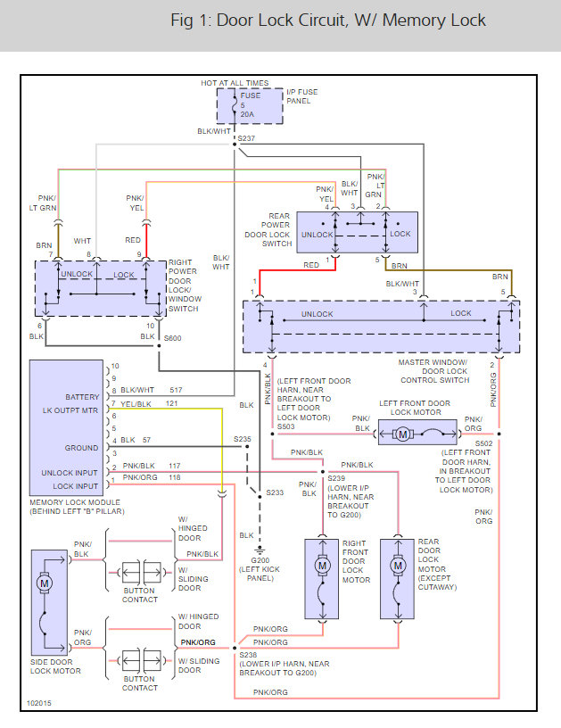

All right, let me know if you find some kind of wiring diagrams that can help me understand how this whole circuit works.
Jun 6, 2018 at 11:30 AM
  • 55,412 POSTS

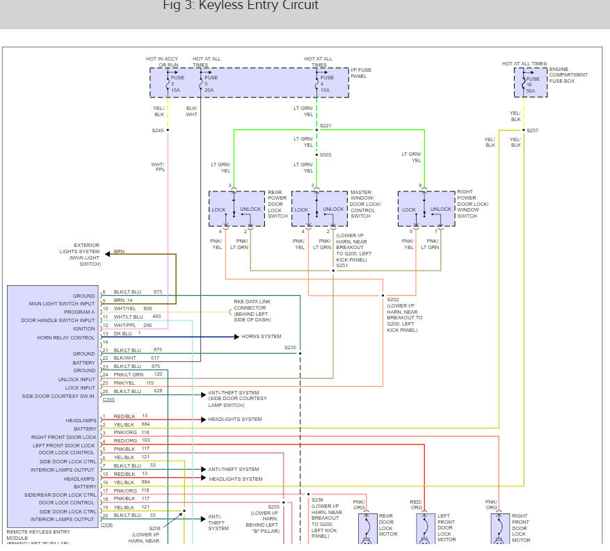

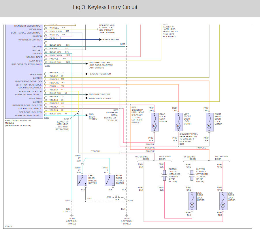

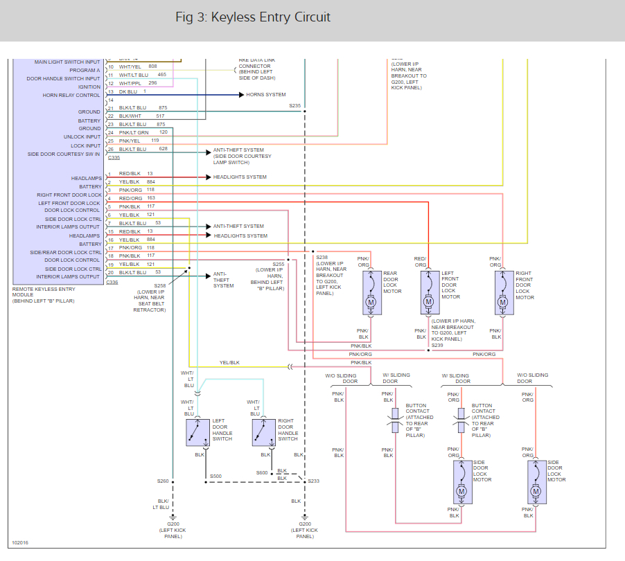

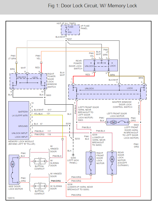

Joe ask me the chime in here are the door lock wiring diagrams. (Below)
Jun 7, 2018 at 12:23 PM
FRENCHIE09
  • 21 POSTS
Wow Ken, that is cool! This will help me ''seeing the whole picture'' of how the system is wired up. I will dig into this and let you all know how it turns out.

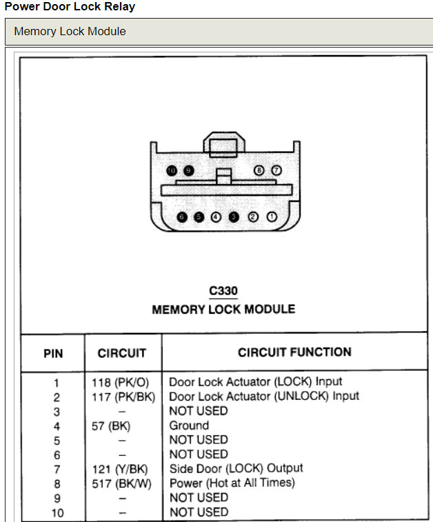

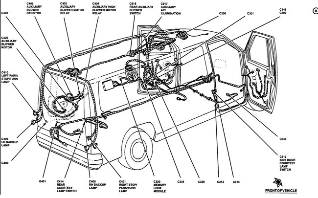

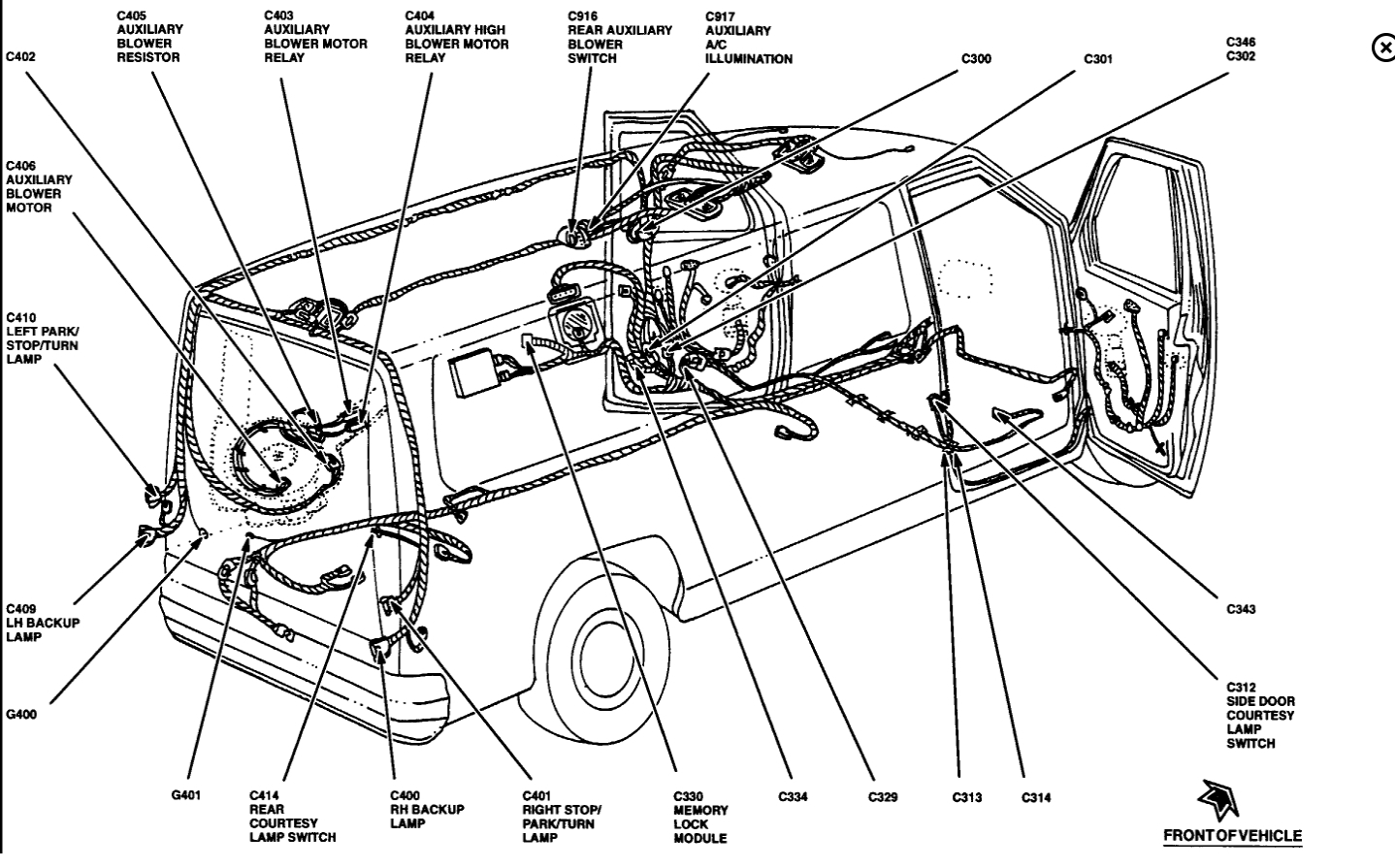

I do not see any wires to the door lock relay! I know it is physically located behind driver seat to the wall. I am assuming my relay might be faulty.
Jun 8, 2018 at 11:49 AM
  • 55,412 POSTS

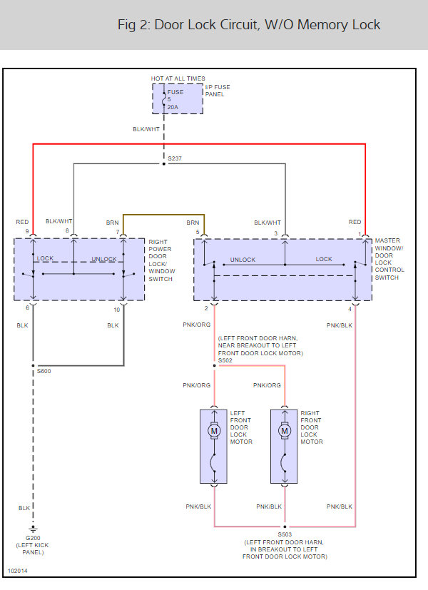

Here is the one that was missing and the location of the door lock memory module.
Jun 9, 2018 at 3:08 AM

Great, thanks again for posting these schematics. Even if I consider myself ''dummy'' at finding mechanical issues, I think I can say my switches (master and passenger side) looks okay. I tested both with a test light, and when touching lock and unlock button test light were lightening. Now does thin indicate my problem might be between switches and actuators? Or relay?
