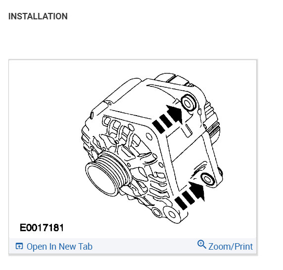

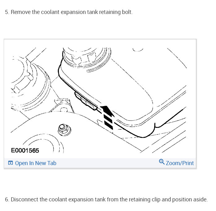

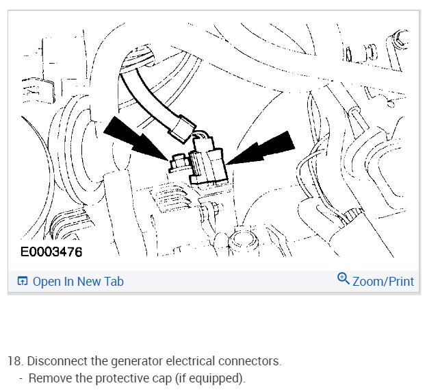

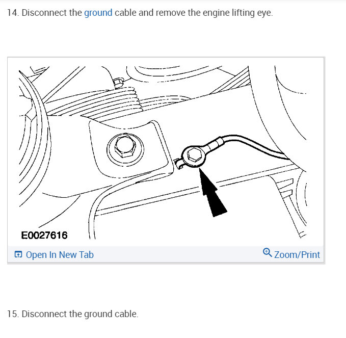

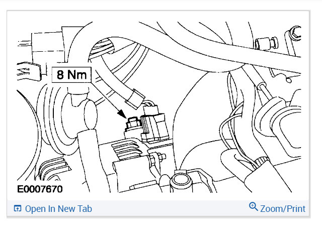

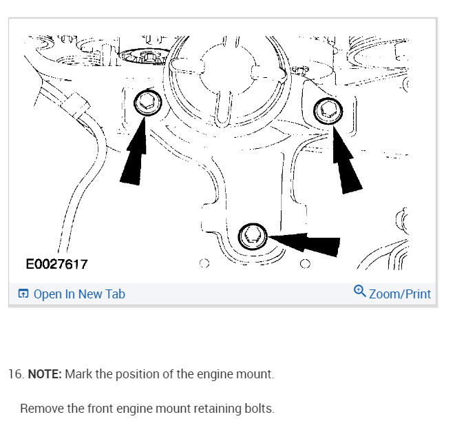

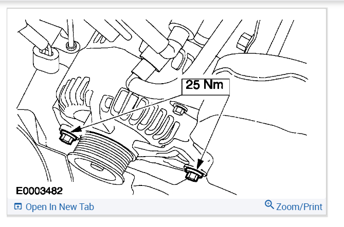

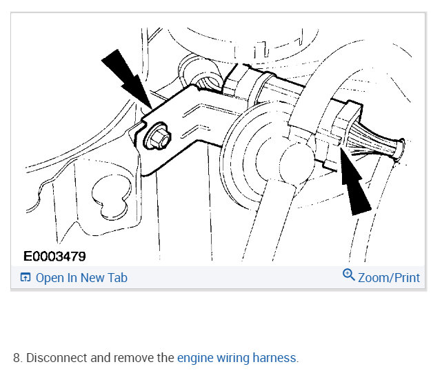

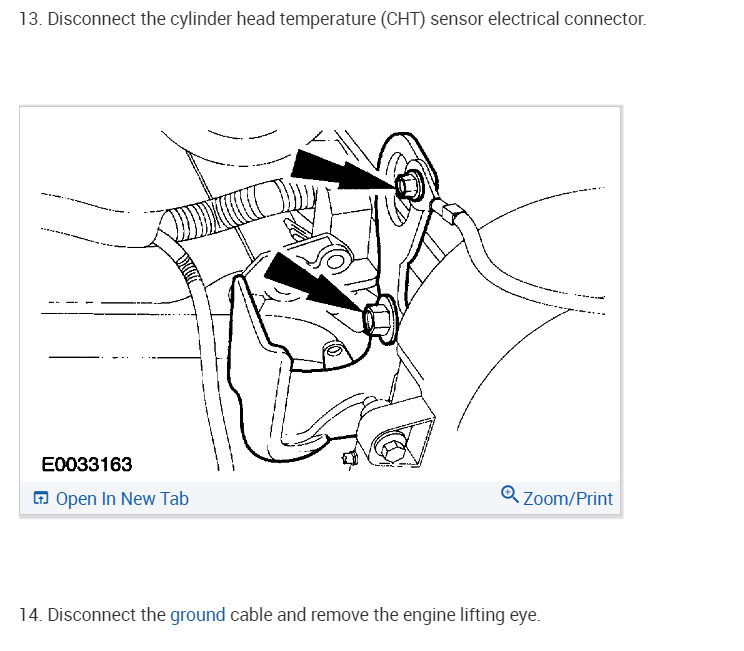

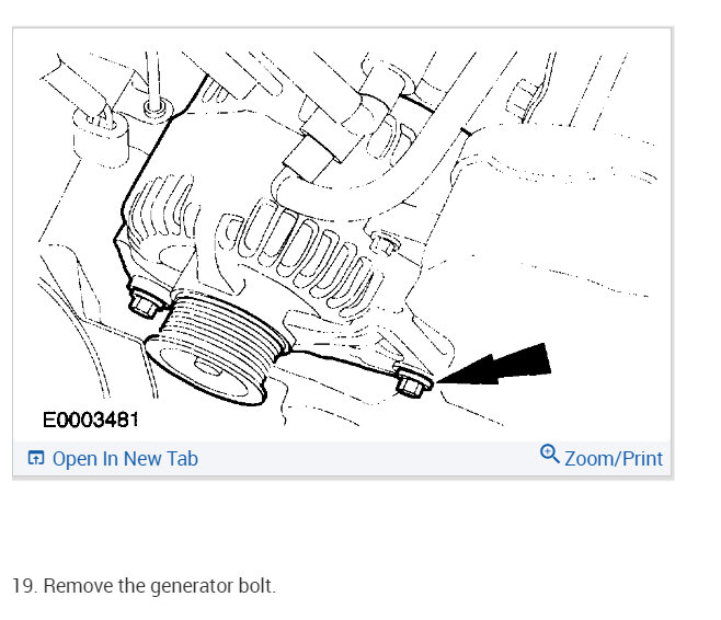

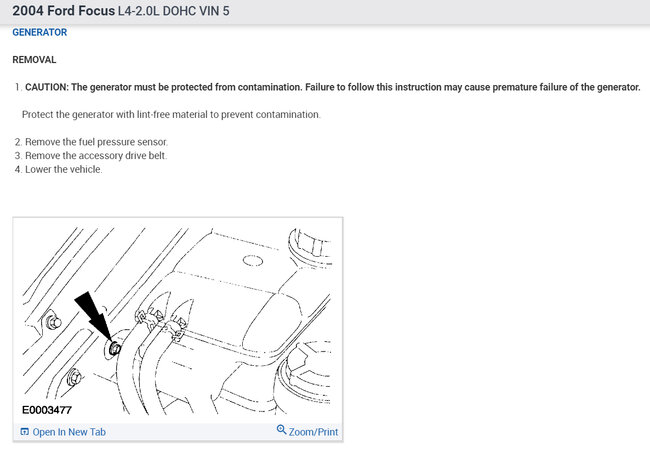

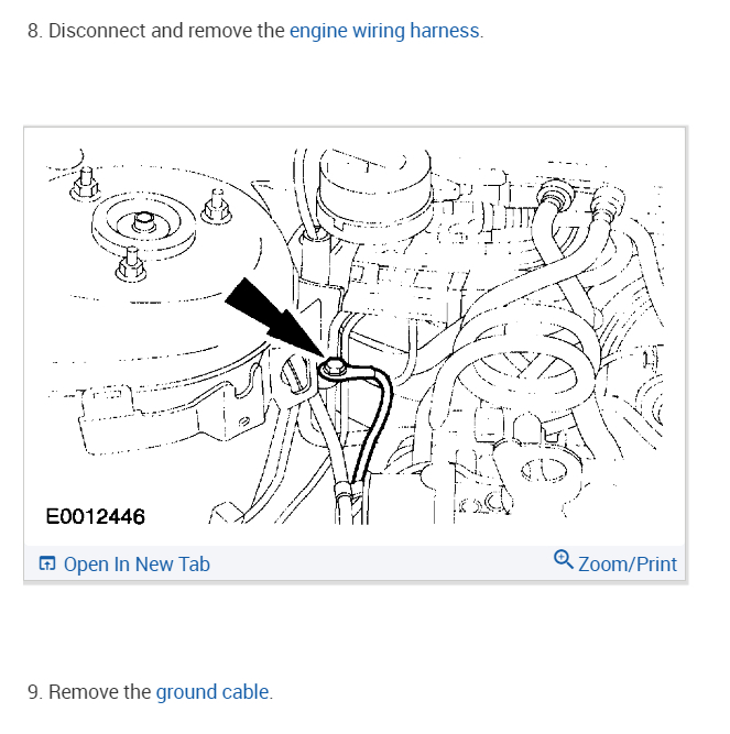

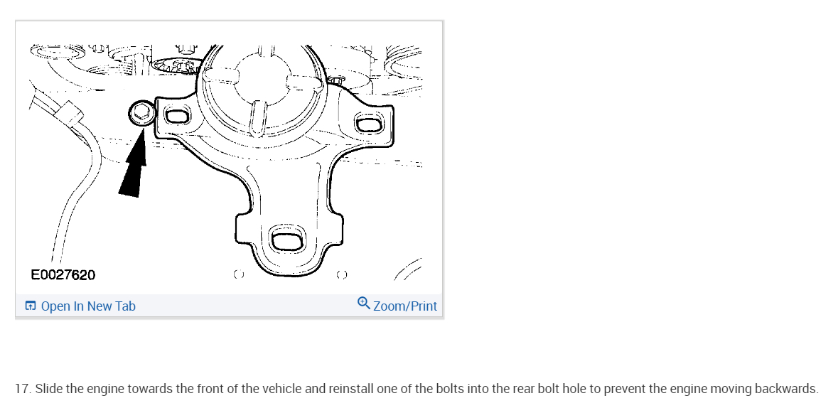

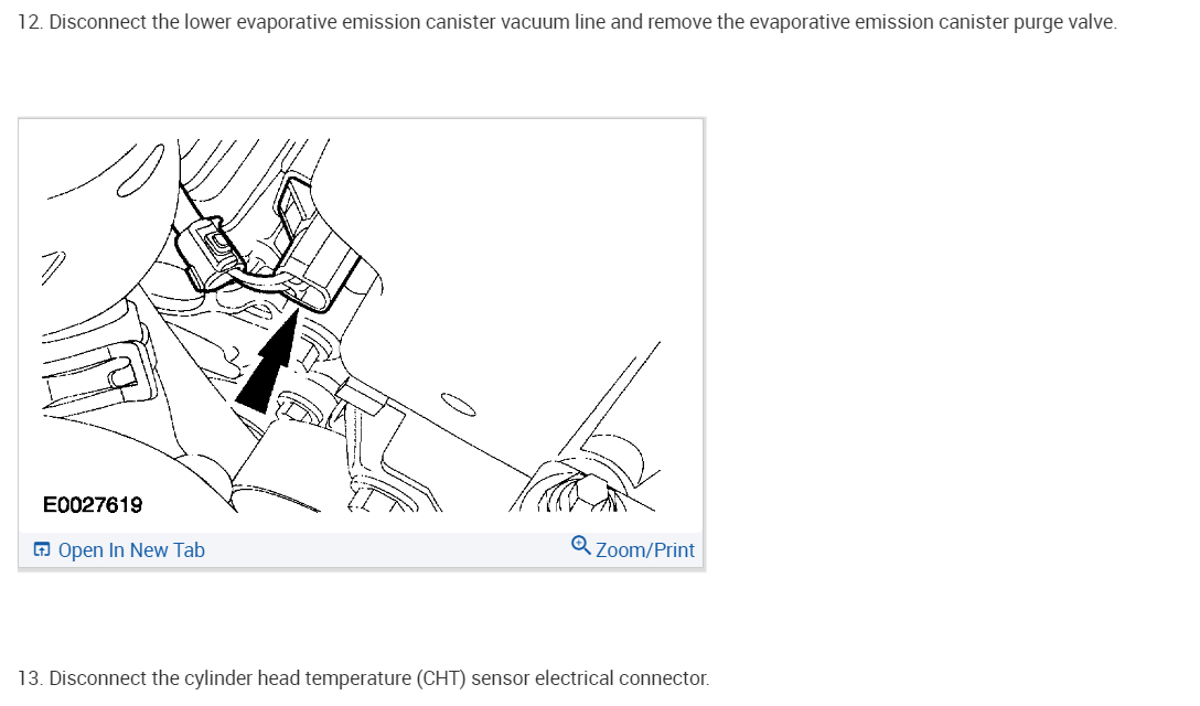

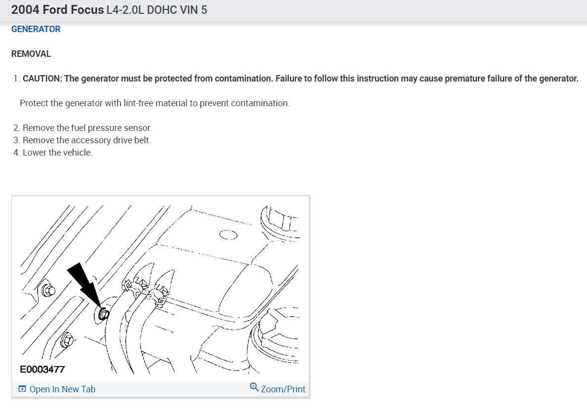

Was the battery light on? This sounds like the alternator has failed but to be sure let's charge up the battery to get the engine started and use this guide to check the alternator output.
https://www.2carpros.com/articles/how-to-charge-your-car-battery
and

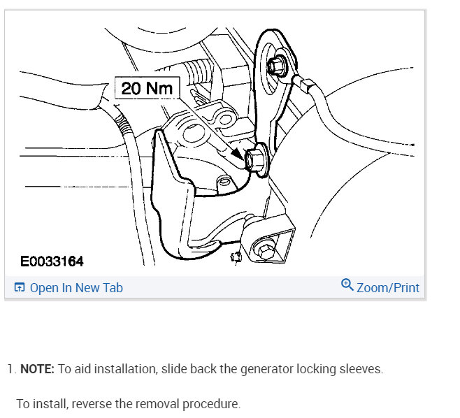

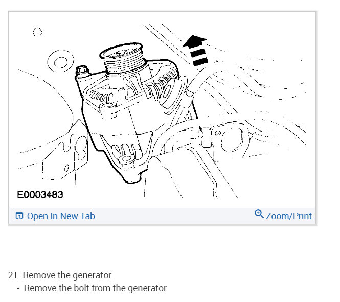

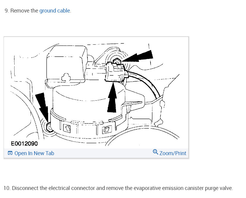

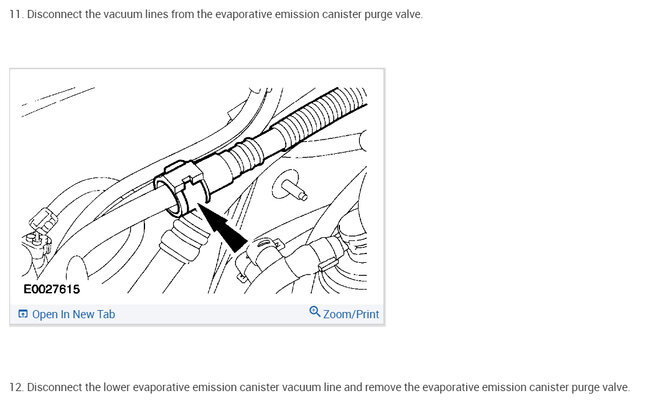

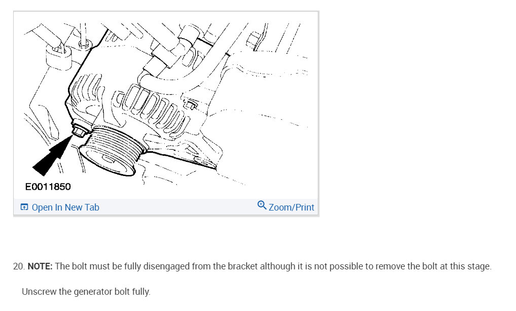

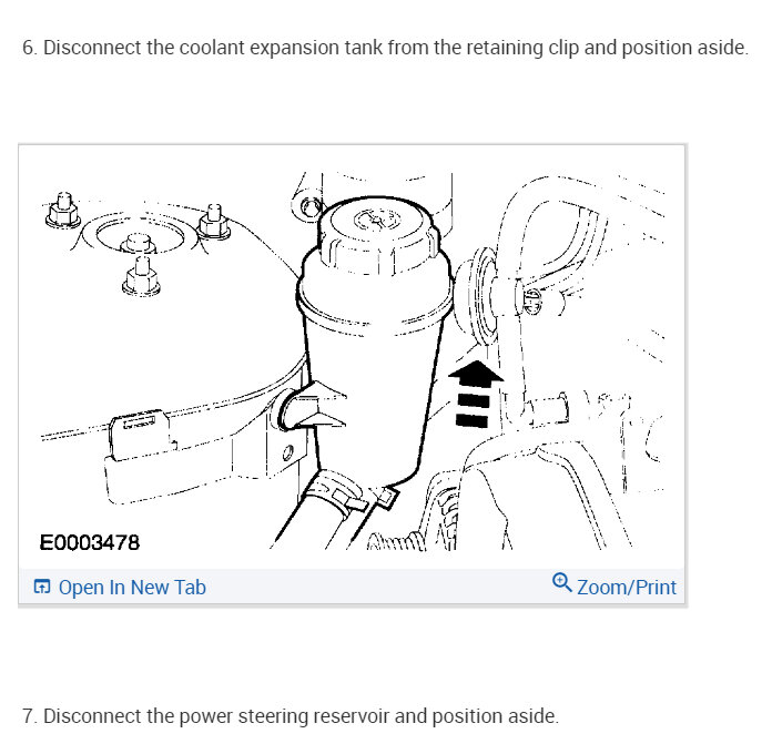

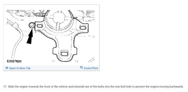

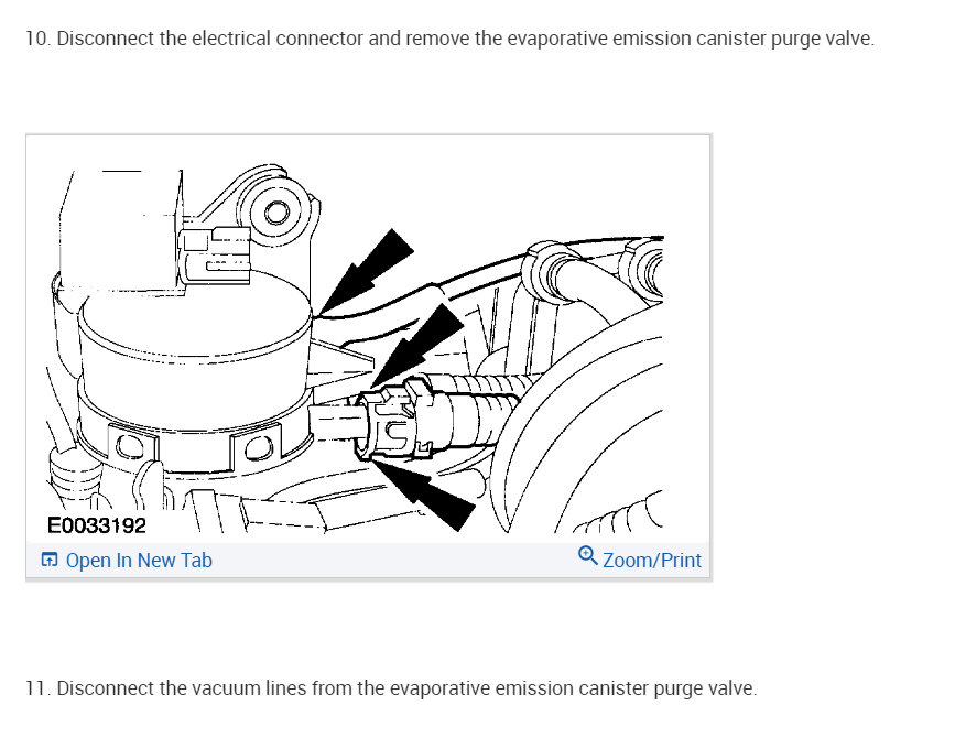

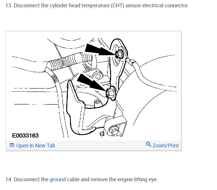

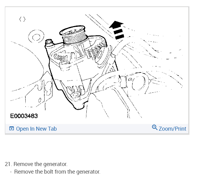

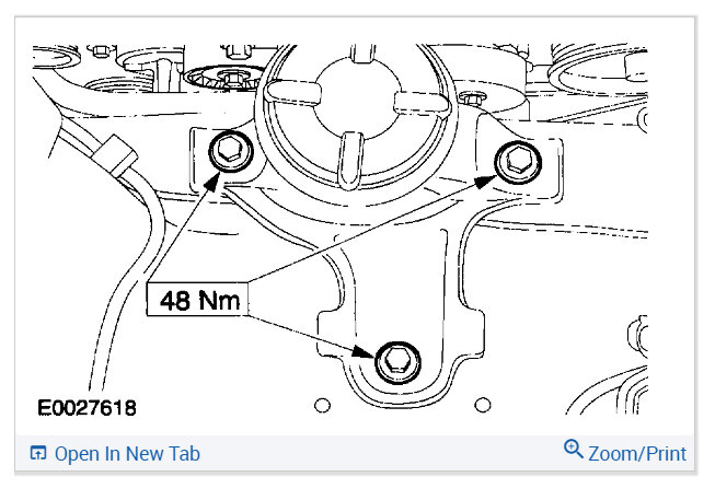

Here is how to change out the alternator in case you need it. Check out the images (below). Let us know what happens and please upload pictures or videos of the problem so we can see what's going on.
