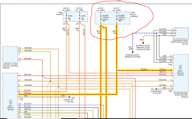

I have the vehicle listed above B6 . My problem started a couple of days before. Some times my windows wouldn't go down from the button on the door but after some miles running it will start working again until 4 days ago it stopped working forever. If i try to open or close all windows from the master power buttons it will work perfectly and only driver window will not work. So i can control passenger's windows without any problem but not mine cant go down or up. And if i try to close or open the windows from the passenger button it will not work too. They have gone all on the same day. Wiring , fuse , window motor they are all okay. but still can't find the problem . I'm thinking maybe any delay/relay may have gone wrong but still can't find all relays connected for the windows. I hope that anyone here can help me.

There are four fuses and no relay related to the power windows. See pic 1. Make sure both are good and have power both to them and out from them. Remember, a fuse can look good and be bad.

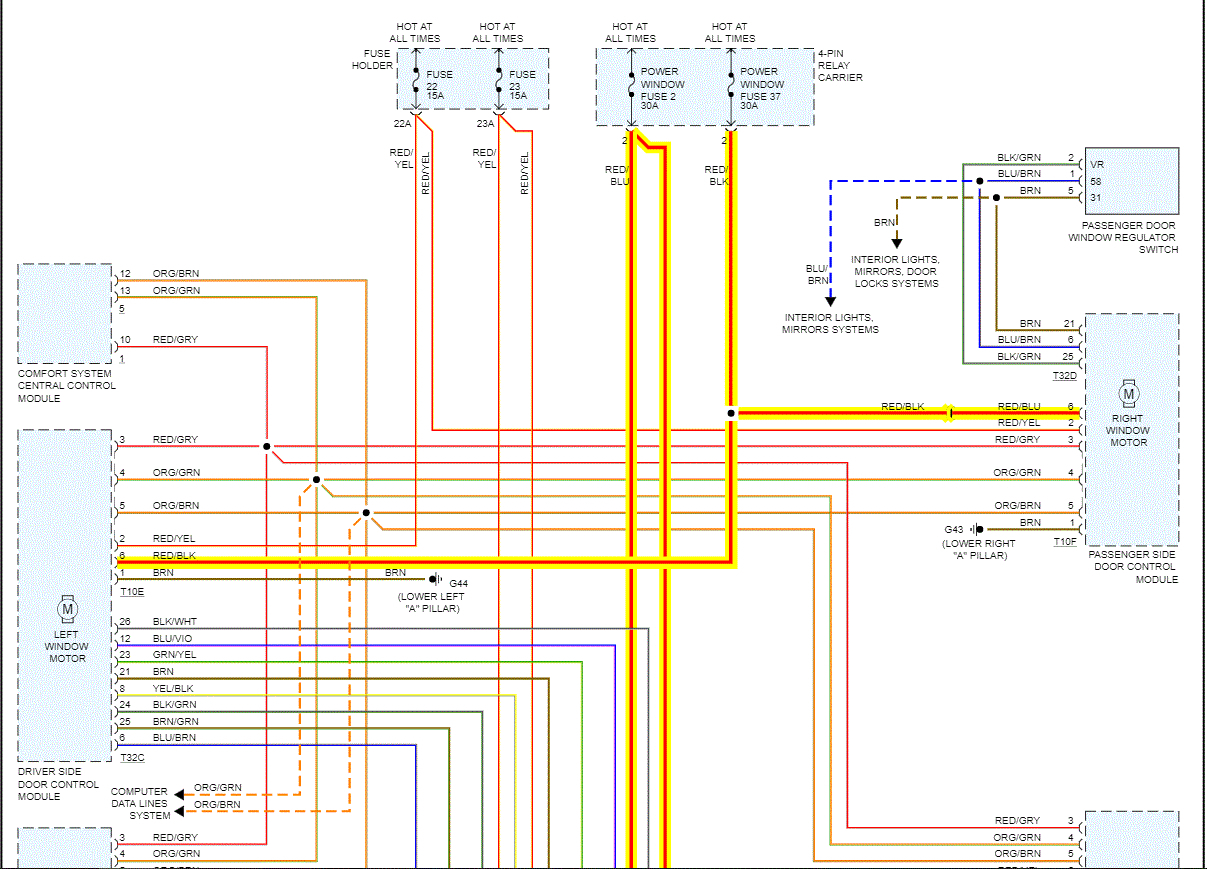

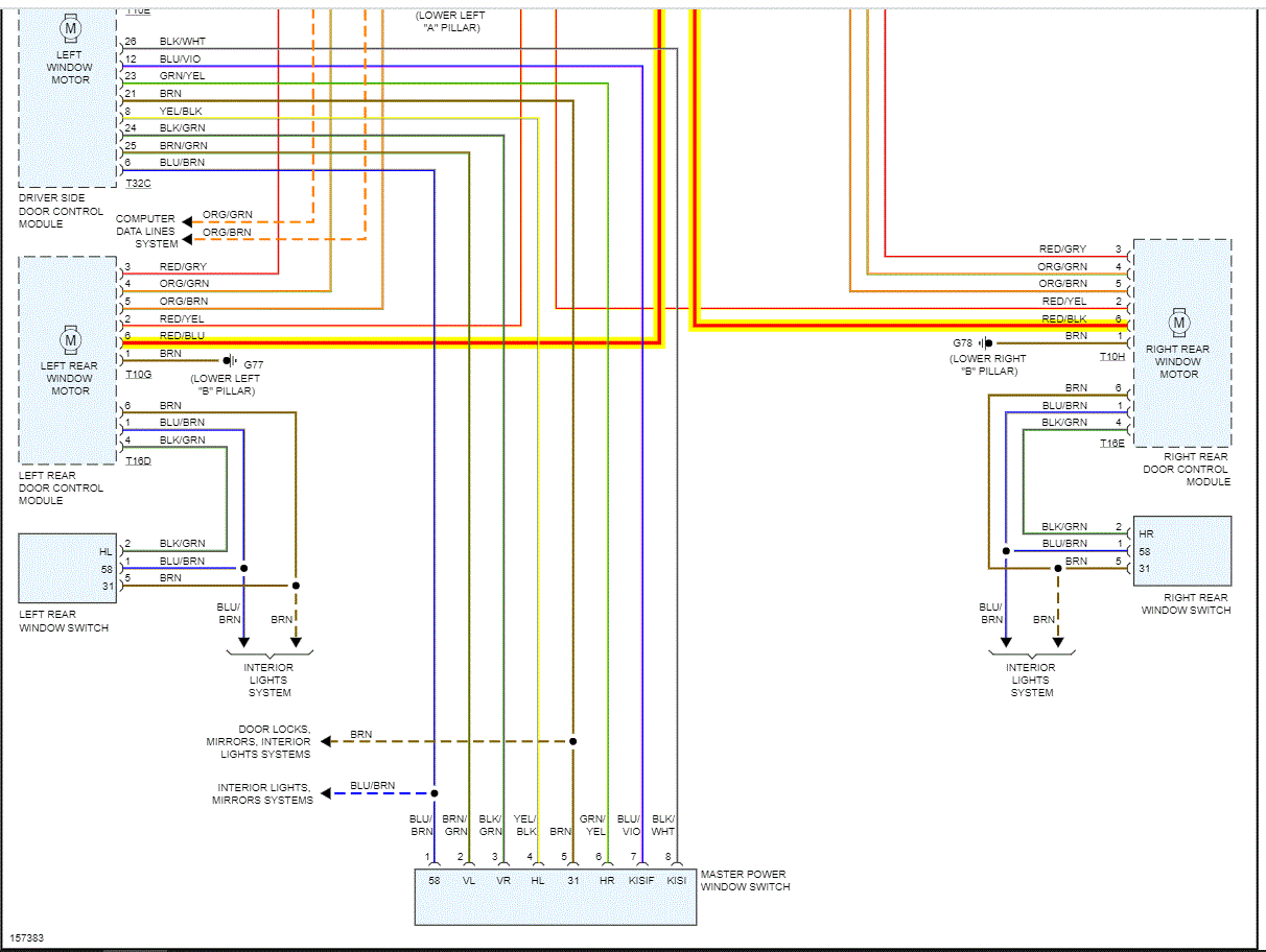

Pics 2 and 3 show the entire wiring schematic for the power windows. Note that I am making the assumption that this is not a convertible. Also, I highlighted the power supply to all window motors/switches. What is a bid difficult to understand is that this. Power goes to the motor before the switch. The switch provides a ground path based on your selection which actuates a motor. What I would start with if the fuses are good is to see if power is making it to the motors.
Next would be to check grounds, but what you described doesn't make sense that it would be a grounding issue because there are separate grounds for each window.
If you find there is power to each motor, then I would suspect it is a bad main switch (driver's side).
Do these checks and let me know what you find.

If you are getting power to turn on the light, then yes there is power. At the motor, I don't have a pinout. However, if you look at the schematics I attached, try to locate the wires by color at the motor.
