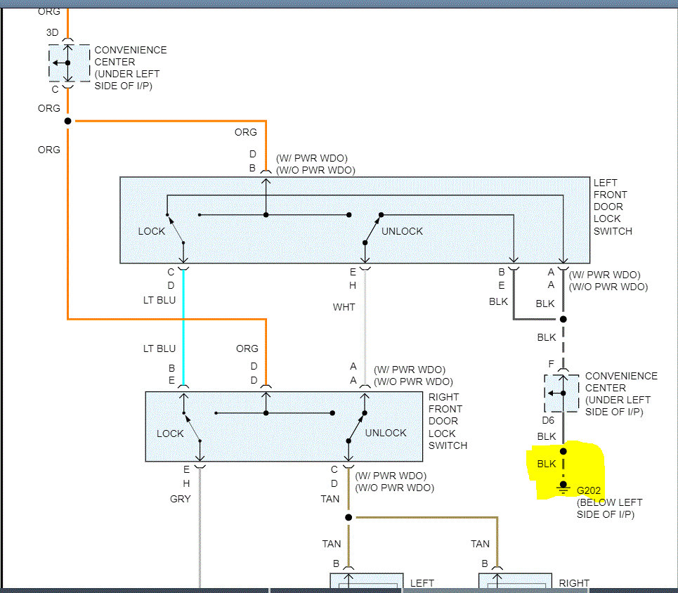

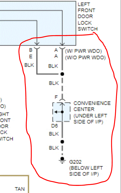

I attached a portion of the wiring schematic. If you have power to the orange wire in the pic and the switch is new, check to make sure the ground I highlighted is good.

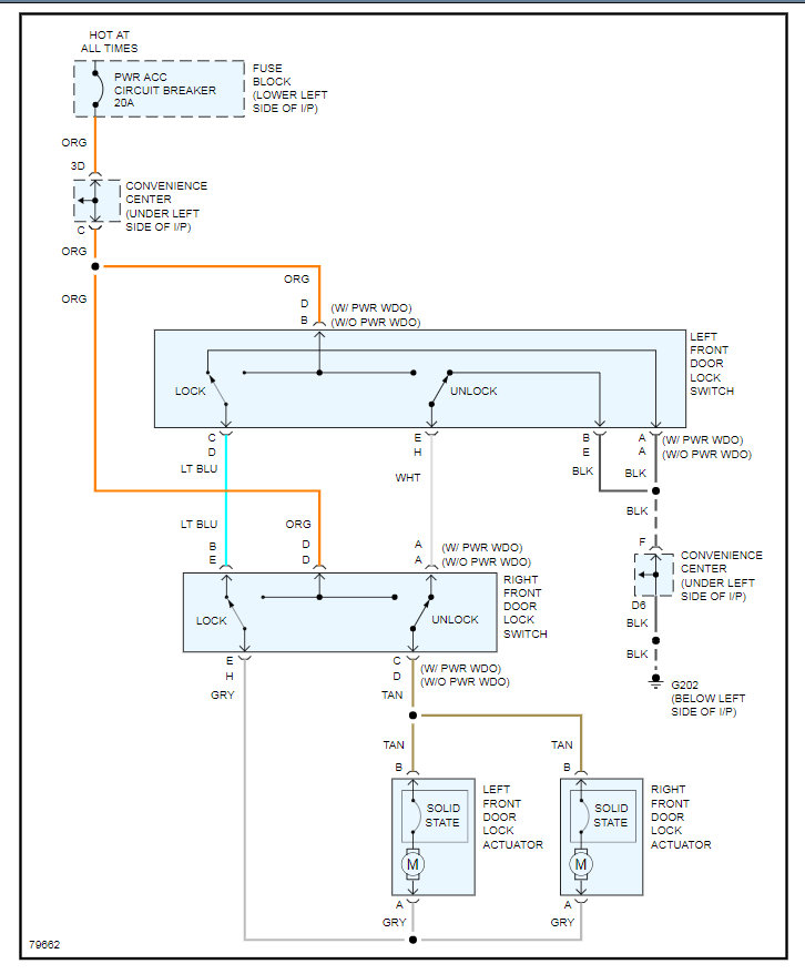

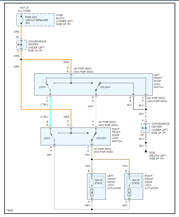

We need find out where you have power on this wire. You said on the driver door but at the switch? Do you have it at the actuator? Check for a short to ground and make sure your ground is good on the switch.
Let me know if you have questions but basically we need to see what is coming out of the switch. Thanks

Looking at a schematic, when you say yellow wire, are you referring to the orange one in the schematic? That should have power at all times. The blue wire runs between the two switches so both locks get power. Since you seem to have power, the problem seems to be one of two things. Either that actuators on the doors are bad, or there is no ground.
Have you confirmed there is ground via the black wire from the main switch? See the pic below.
