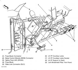

Maybe the lock fuse for pass side located instrument fuse box # 22 15 amp

In same fuse box switch out lock relay with unlock if it locks then relay faulty

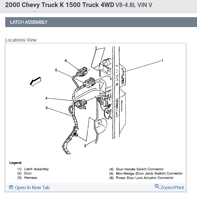

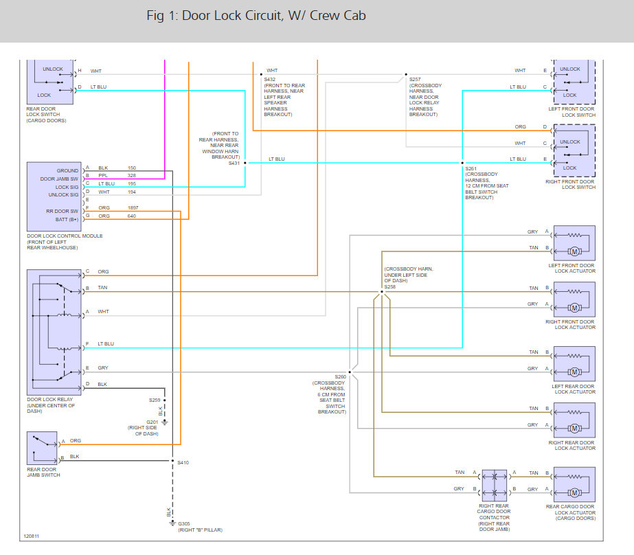

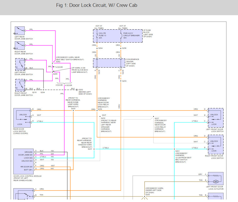

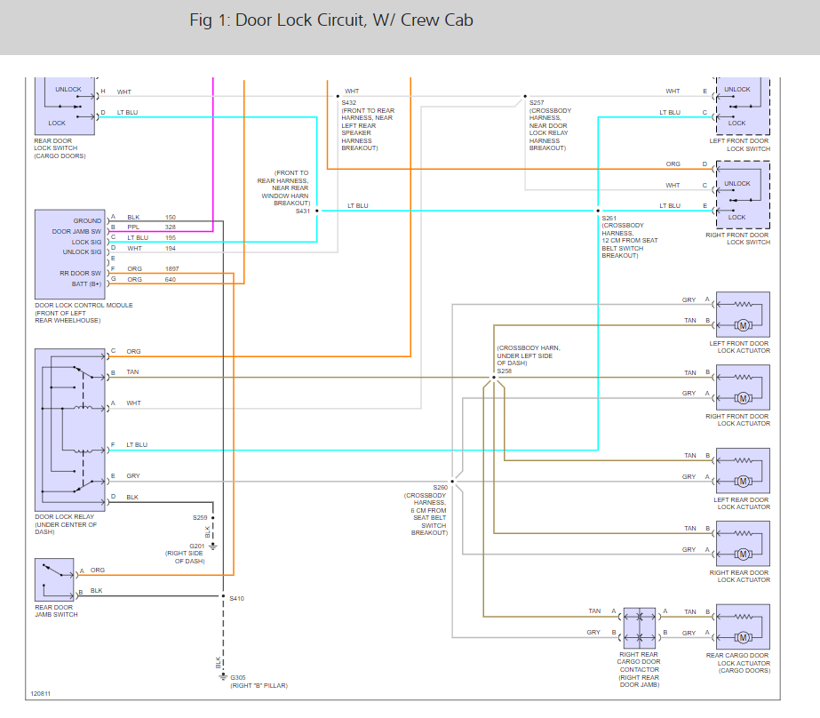

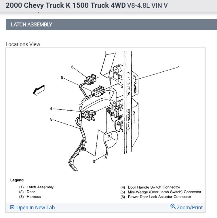

It sounds like the door lock actuator has gone out but to be sure here is a guide to show you how to check for power at the lock actuator and how to replace it in the diagrams below.
See if the actuator gets power when the switch is activated.

Okay, I would check the wiring because it sounds like one of them is broken or it has a bad connection use the door lock wiring diagrams from above and this guide to check the connections.
