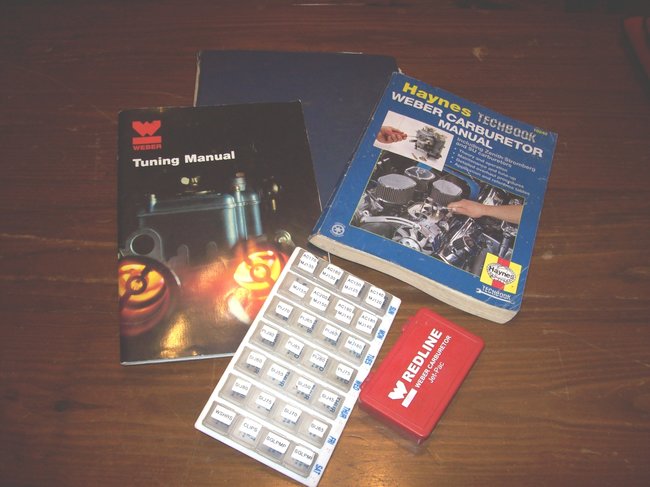

The fuel smell is probably normal if your exhaust runs straight out of the rear.
I started kicking mine out of the side behind my rear driver's wheel years ago to eliminate what you are experiencing now (me and my passengers weren't fond of the smell either) See pics 1 and 2.

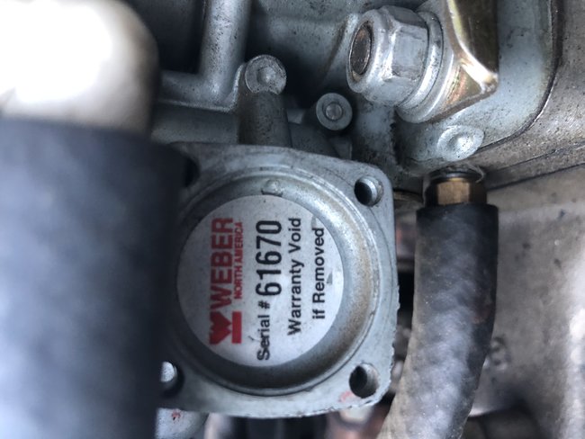

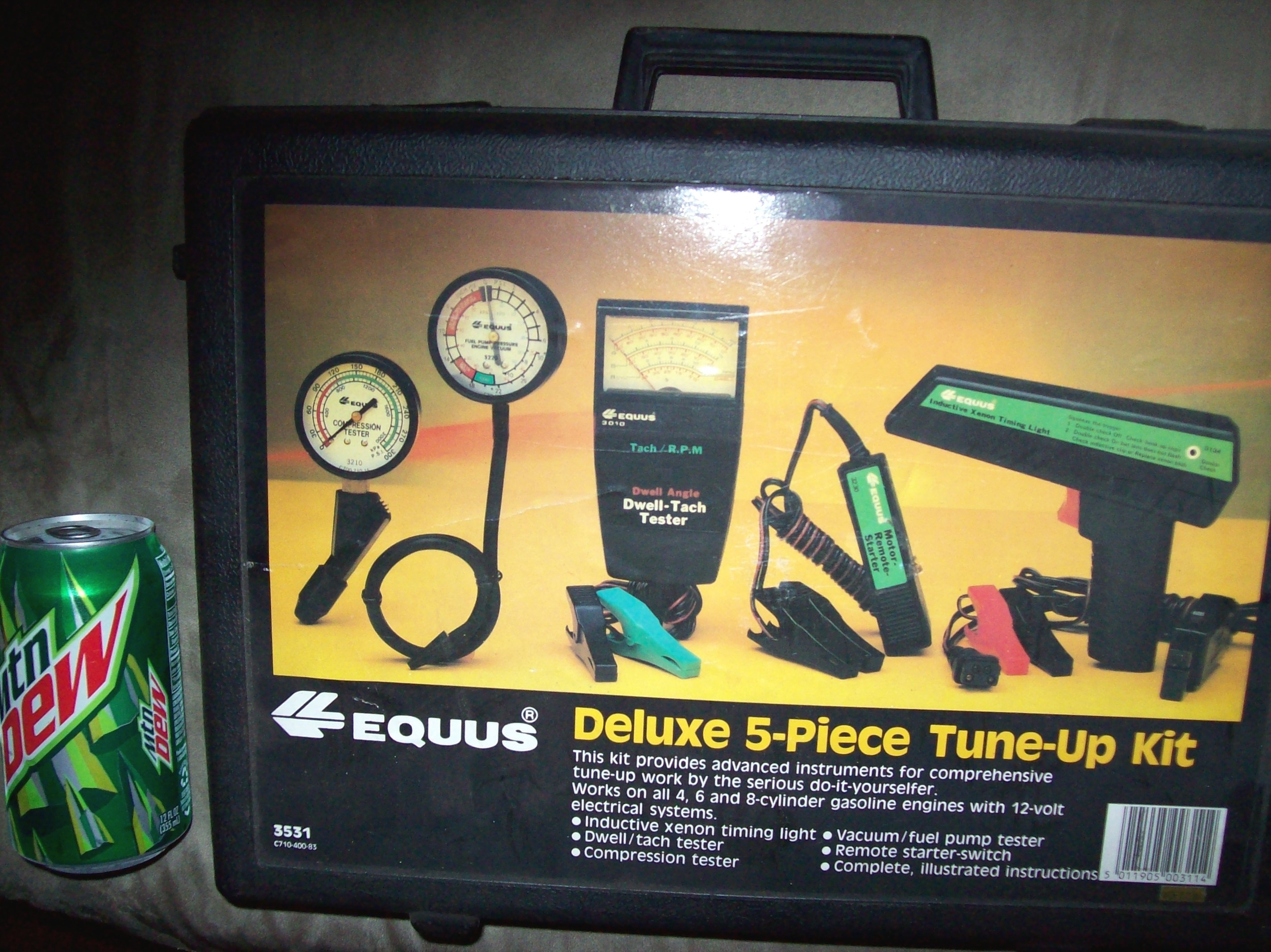

1) Have you tuned your rig using instruments- timing light and a dwell/ tach or vacuum gauge? Is it possible it has not been tuned correctly? See pic 3.
