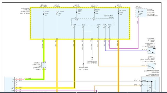

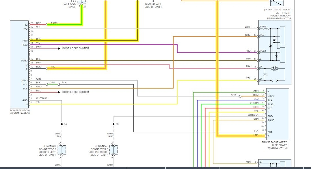

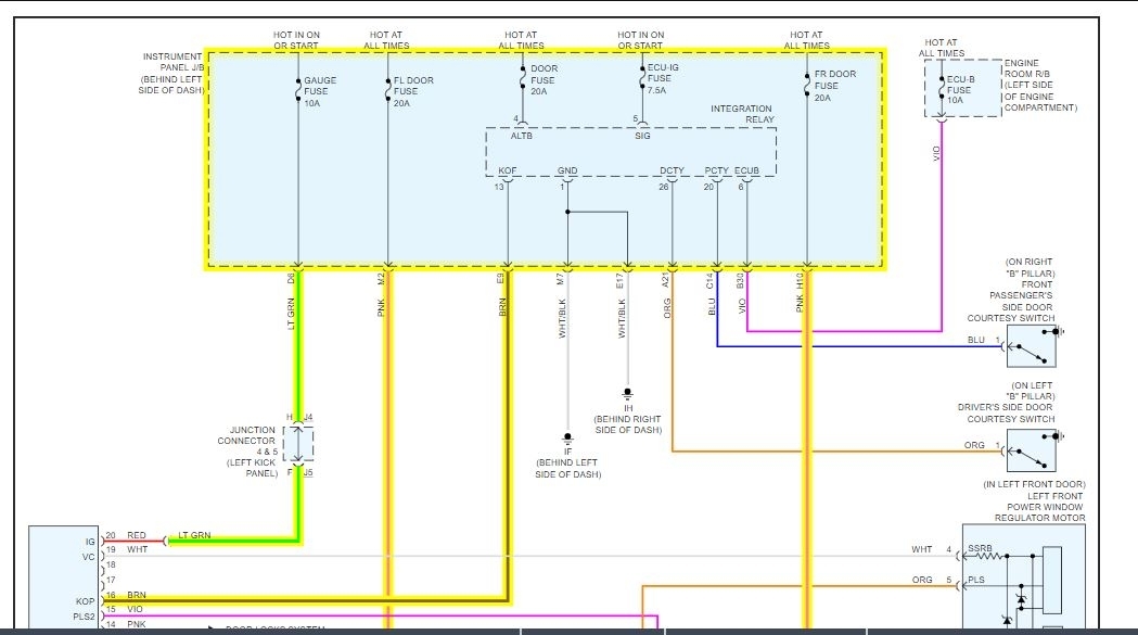

I attached a wiring diagram for you to view.
Mar 2, 2020 at 4:52 PM
