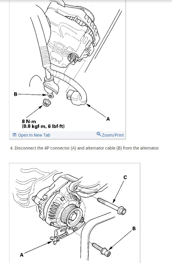

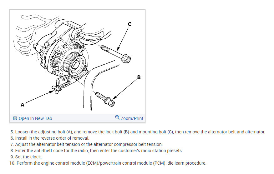

Thank you, I really appreciate it. I kind of figured it was the alternator but it's always good to have a professional opinion. Do you think it's something I should even attempt myself being it's probably my first DIY under the hood. I would like to be able to work on my own car eventually. But I just don't know if this would be a good place to start?
Jul 18, 2021 at 11:57 PM
I think you can do it, just take your time. Follow the instructions and make sure you put back everything you take apart.

One last thing; is there any specific tools I need like a belt tensioner? I just have the basics, I know some videos are saying I need a jack stand but all I have is the basic jack the car comes with?
Jul 20, 2021 at 11:12 PM
No, basic tools are all you need for this repair.
A standard wrench will release the tensioner for the drive belt.
Jul 21, 2021 at 1:13 AM
CJC719
  • 14 POSTS
Is there a way to make sure the belt tension is correct? I know if it's loose it'll squeal or whatever.
Jul 26, 2021 at 6:10 PM
It needs to be taunt. make it tight so there is no deflection in the belt.

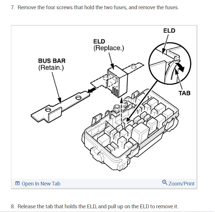

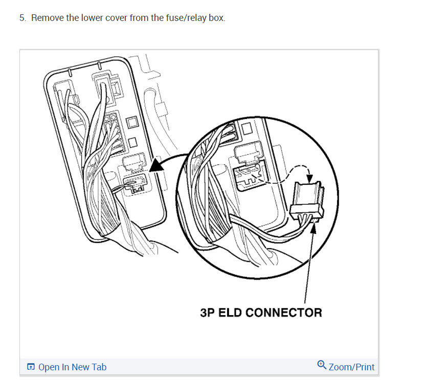

Okay, well it's good thing I got a warranty. I will just swap for another and see what happens. Last question, is there anything else that it could possibly be if this doesn't work?
Aug 4, 2021 at 6:04 PM

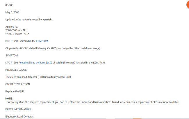

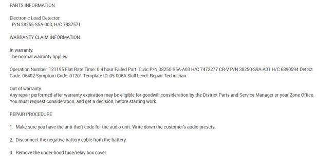

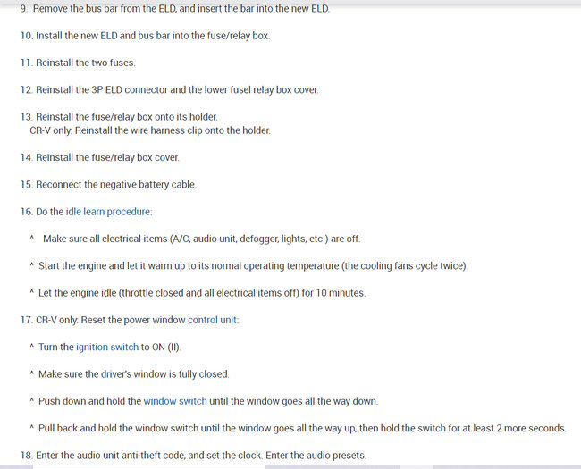

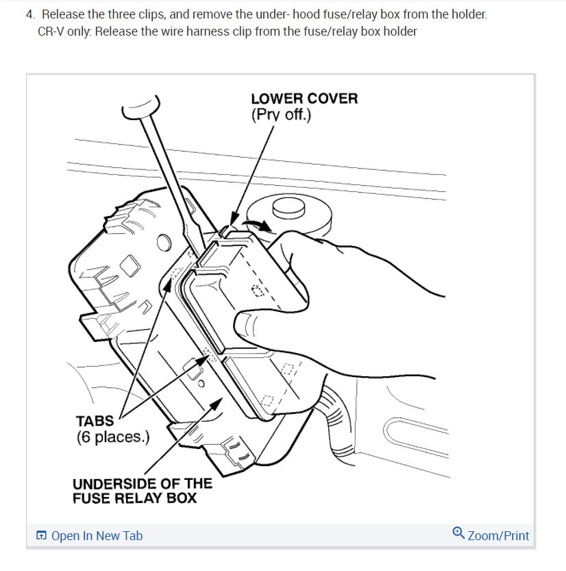

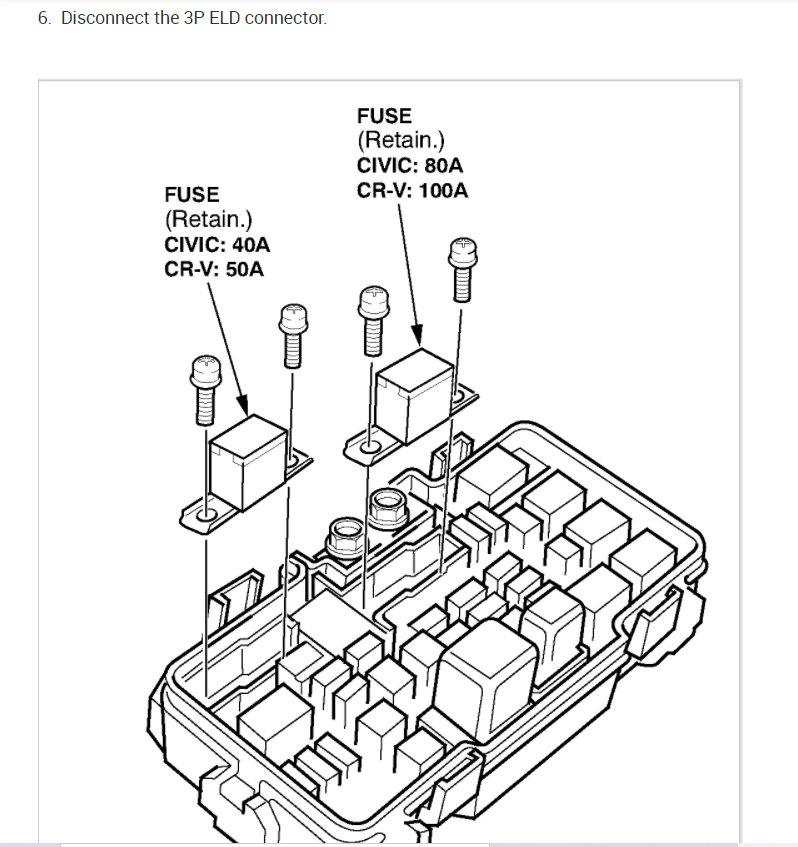

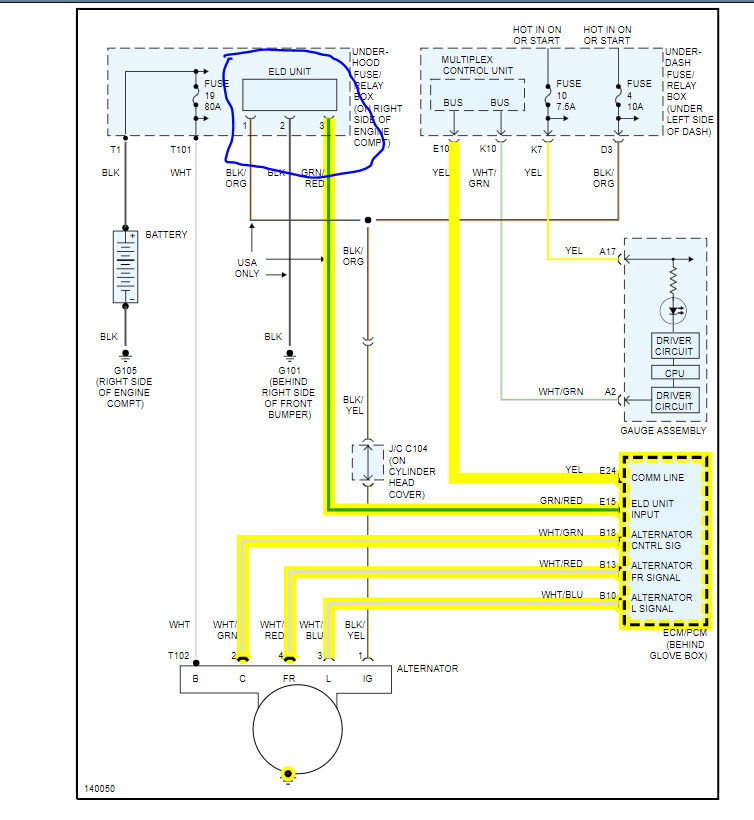

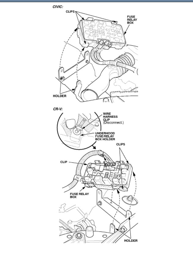

The alternator is responsible for the charging system. There is nothing else in the circuit.
The only other thing is the ELD unit in the underhood fuse box. It is rare but could cause the issue.
I attached the description and the procedure for you. If it is that, the fuse block has to be replaced.
