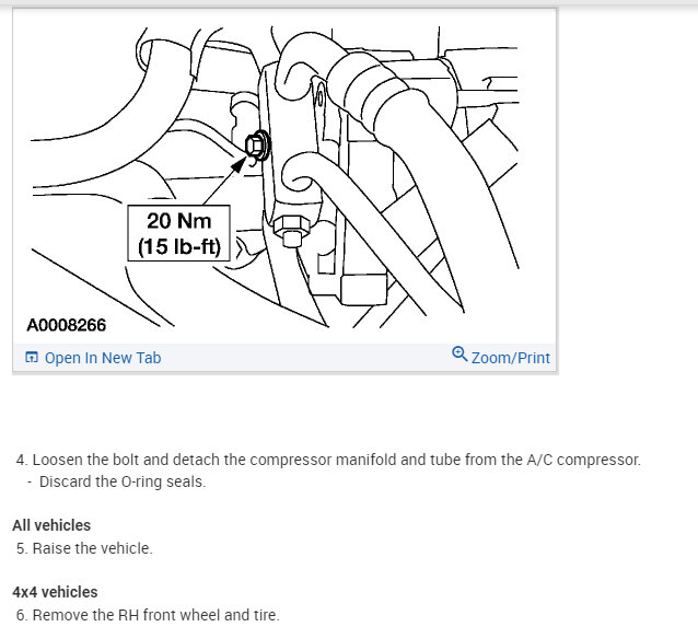

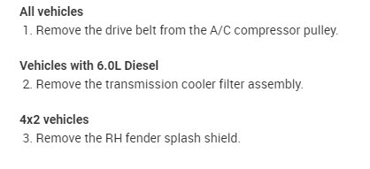

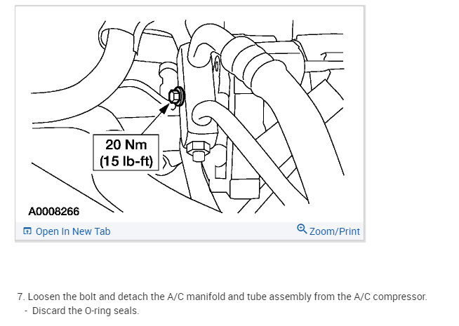

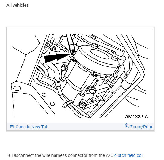

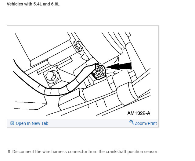

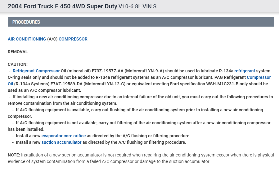

The A/C compressor is bad. the clutch wasn’t turning with the belt it would spin and then stop then spin and stop so it’s bad.
Jul 22, 2023 at 10:57 AM

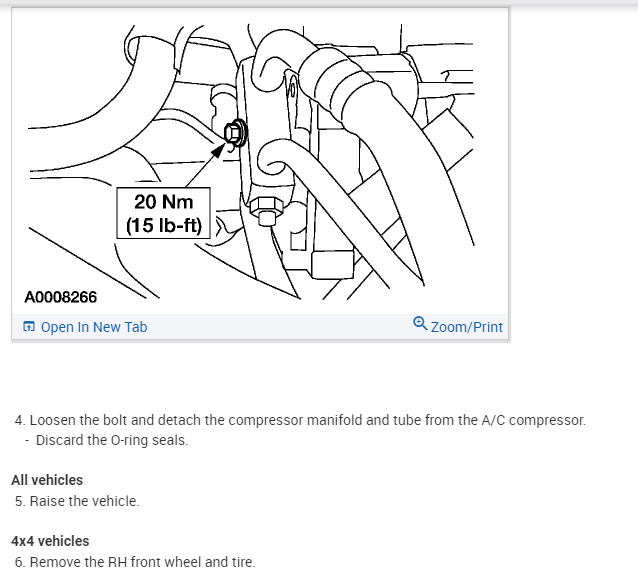

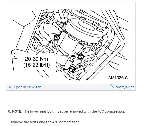

  • 110,248 POSTS
It sounds like the compressor is locked-up. Or, the belt is loose, but I feel confident that is something you checked.
Regardless, I don't know if you need them, but I attached directions for removing and replacing the A/C compressor. See pics below.
Let me know if that helps or if you have questions.
