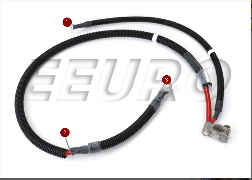

Hi guys. I desperately need to replace the positive battery post and cable assembly. It is frayed at the ends and has separated from the cable and wires. I bought the whole cable which has three contact points. It's more involved than I thought. I want to do this safely and confidently, so I thought I'd check with you.

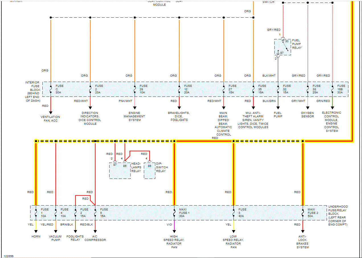

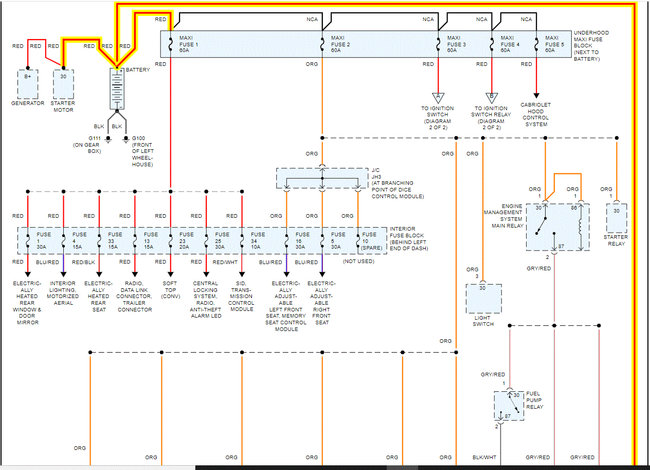

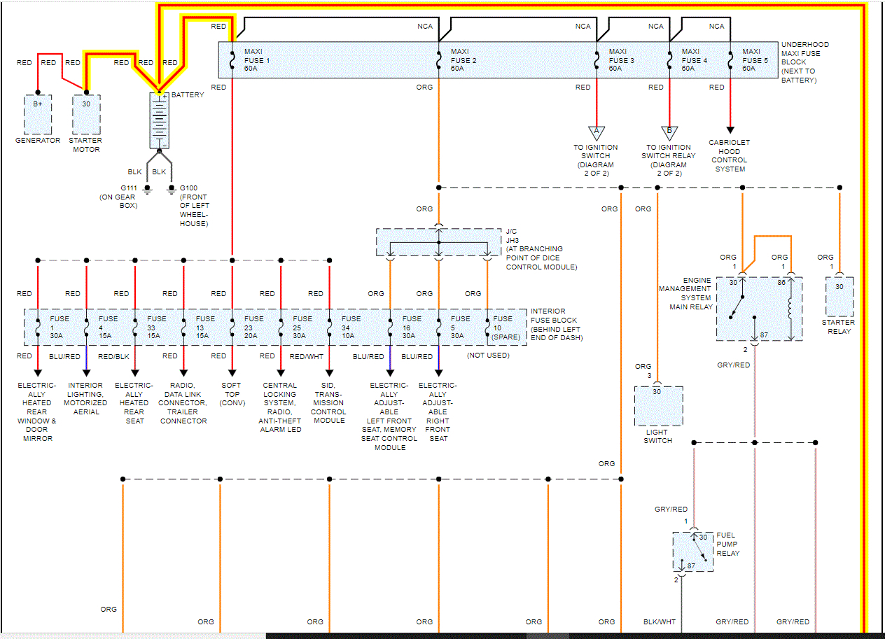

If you purchased an original equipment part or a direct fit, simply connect it at the same locations. I would recommend having the negative battery terminal disconnected when doing this.
Now, I looked at the power distribution schematics. It does show three locations. Two of the connectors go to the under-hood fuse box and one goes to the alternator. Take a look at the schematic.
Please let me know if this helps or if you have other questions. Note, if the cable you removed doesn't have the same design, there could be a few different reasons, so let me know.
See pics below. Note, the pic was one page long. I had to cut it into two pics to make it readable. I did overlap them so you can follow from one to the next.

Hi Joe. This doesn't really help me because I don't know how to read schematics. Photos and step-by-step instructions of how to access the area are more helpful to me. I can see where the connections are to be made but I was hoping someone had a write-up of what to remove in order to access the contact points. There is very little space in that engine. FYI, the cable I removed has the exact same design. I have connected the first point at the fuse box. I can see two more in my vision, and the third goes around under the engine. I don't know how to access these areas.

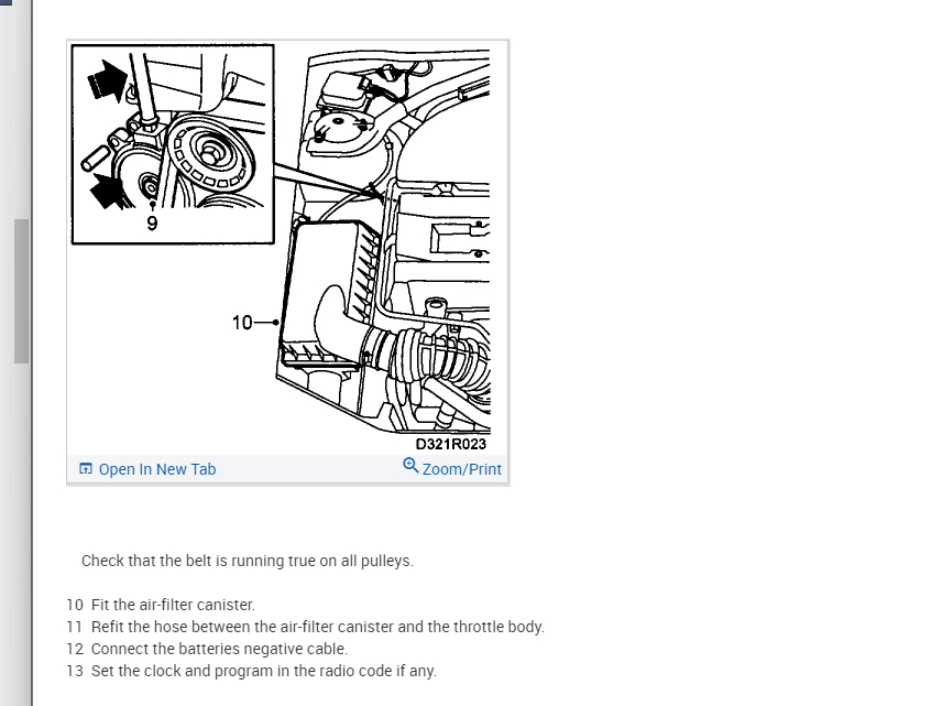

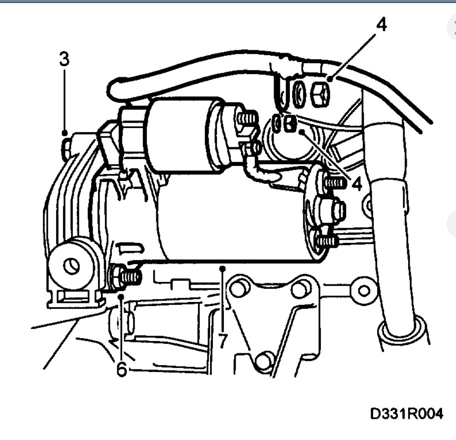

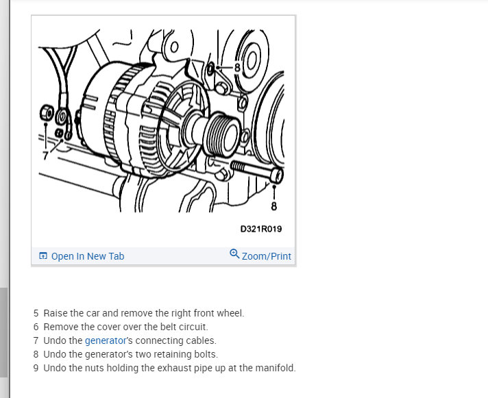

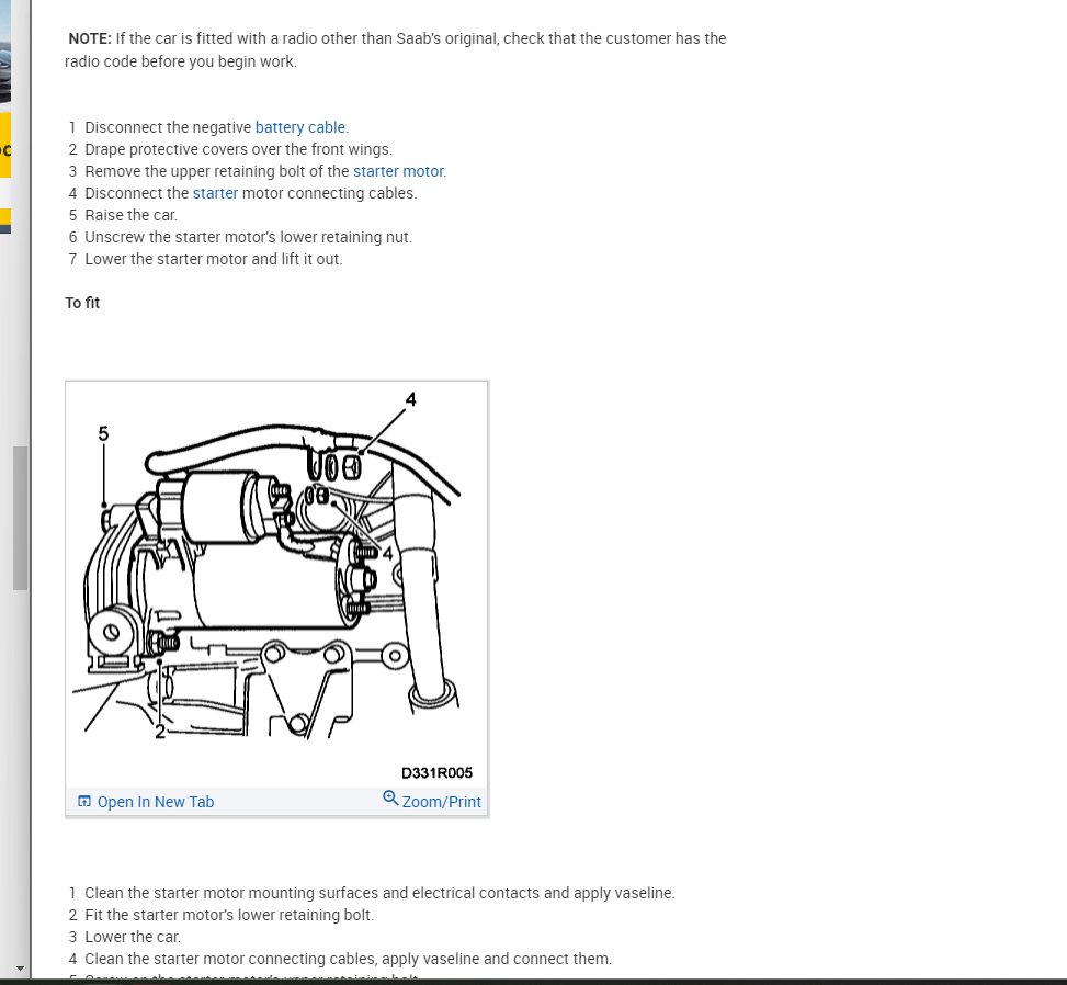

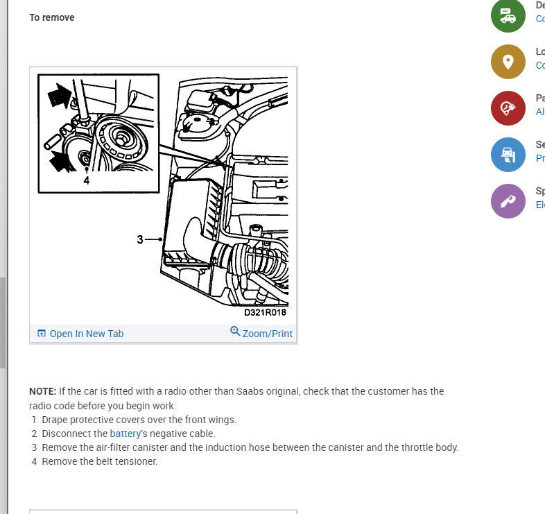

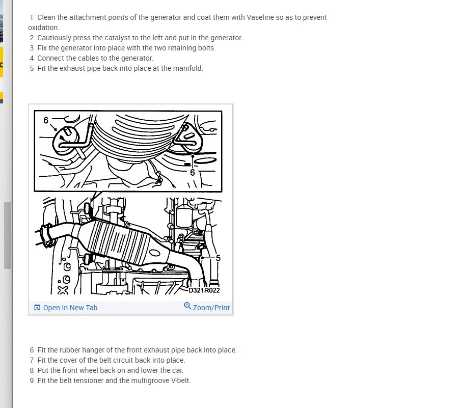

Just to jump in on this. We don't have a set of instructions on this vehicle for this battery cable.
Unfortunately, that is one of those parts that they figured the mechanic would just figure it out based on how they are removing the old one.
So, if you look at the wiring diagrams that Joe provided, you will see there are three connection points that you are seeing on the cable.
Those connections are for the starter, alternator, and fuse box.
Take a look at the attachments below and you will see these connection points.
I labeled the picture of the cable so point one goes to the fuse box, point 2 is for the starter and the last is the alternator.
I included the replacement process for the starter and alternator so that you can see where these points connect to.
Please let us know if you need more info. Thanks
