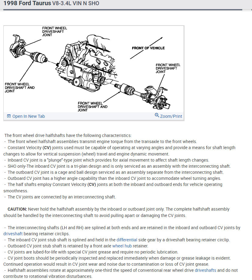

When I take off I hear a popping sound like my tire axle about to break and I can feel it under my gas pedal. then as my speed picks up it meddles out but as long as I slow down and increase speed it will make the popping sound again.

It sounds like you might have a CV axle that is defective. As the CV what turns the wheels, when they are under load, when you accelerate they make the popping noise.
You might want to have a look under the front of the car right inside the wheel (where the CV shaft goes in). Many times the CV boot ruptures and you will have grease coming out.
