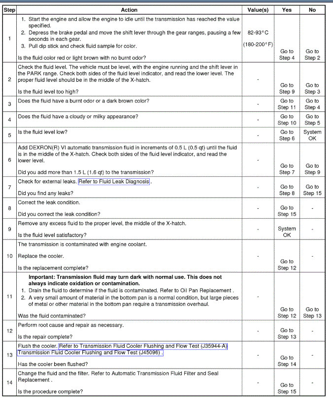

i have a 2009 chevy impla and my traction control came one and my car wont go over 40 mph. can you give me some pointers
Sep 17, 2020 at 4:37 AM (Merged)
GMTECH
  • 537 POSTS
It sounds like the car is in limp in mode with means there is an issue with the transmission/engine traction control. This guide can help us fix it

Do you think this could be the transmission. If so how will I know that.
  • 110,244 POSTS
I doubt it is the transmission. If the transmission was causing this, chances are the engine RPM's would increase when it slows down indicating slippage.
