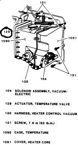

The cooling fan works fine. The thing that puzzles me is when it starts to overheat, the heater starts to blow cold air.

The problem should be either a blockage in the heater core or a defective heater control valve.
note the temperature control valve(129)
https://www.2carpros.com/forum/automotive_pictures/46384_heater_core_3.jpg
What we need to do is to compare the temperature of the heater inlet and outlet hoses where they enter the firewall. Both should be hot, and the inlet hose should be about 20 degrees warmer than the outlet hose. If the outlet hose is not hot, the core is clogged or the heater control
Valve is defective. If reverse flushing the core fails to open the blockage, you will have to replace the heater core.
