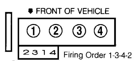

trying to find a wiring diagram for a 1995 pontiac sunfire 130,000 miles 4 cylinder diagraam from distributor cap, wires to spark plugs. trying to get the firing right. Any help would be great. cant see the cap so relying on touch. :?:

this is for a 2.2
https://images.2carpros.com/forum/automotive_pictures/59481_Noname_8.jpg

Use the expert's 2.2 distributor-cap-to-spark-plug wiring diagram to set the firing order correctly rather than routing the wires by feel.
Conversation Summary
The owner of a 1995 Pontiac Sunfire with a 4-cylinder engine and 130,000 miles asked for a distributor-cap-to-spark-plug wiring diagram to get the firing order right, noting the cap could not be seen. An expert said the diagram is for the 2.2 and shared an image of the wiring layout.
