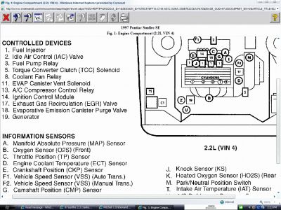

Where do i find the crankshaft position sensor on my 97 pontiac sunfire 2.2? I was told it was by the fuel injector but i cant seem to locate it. Some specific location or a diagram would be nice. If someone could help i would appreciate it.

Rear side of the cylinder block, below the coil...
https://images.2carpros.com/forum/automotive_pictures/62217_Sunfire_CKP_1.jpg

Locate the crankshaft position sensor on the rear side of the cylinder block, below the ignition coil.
