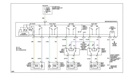

I lost power to two of my windows, front passenger and rear driver's. It is a four-door, if that matters, as far as the back one goes. All the connections test out okay. My friend said to check the relays but I have no clue where they are.

There's no relays -Test the master window switch your problem is coming from there.
https://images.2carpros.com/forum/automotive_pictures/12900_window_6.jpg

Thanks, once I knew there was no relays I just checked for power at the wires while somebody pressed up and down on the switches, was a short in one of the two wires to my drivers window motor, ran a new wire and now it works great.
PS: pictures to small to read the text, but thanks all the same :)
