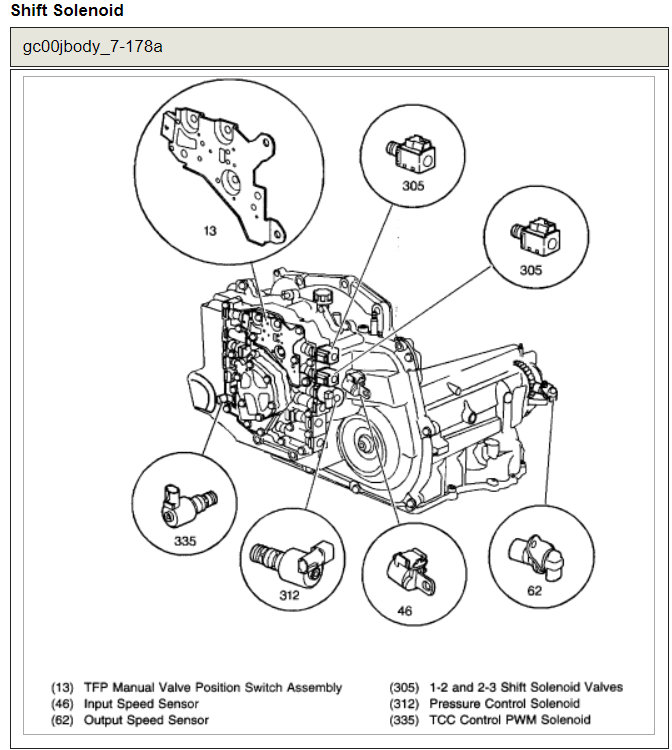

I just bought the car a few weeks ago and it was running fine. Slowly it would act like the transmission was slipping. the engine runs perfect and sounds perfect. now it will not shift up after 2nd gear. fluids are fine, no codes, starts fine, runs good, changes from 1st to 2nd smoothly. what would stop it from shifting?

i took it to a trans shop. of course they said i need a new trans and misc stuff adding up to $2800. i said screw it, i will do it. i got the car back and drove ten miles. it started doing the same thing!!! i heard a loud bang right by my foot. must be the trans, i thought. i took it back and they tested it and have not found anything. it also did not show the same symptoms after 50 miles of them driving. so i dont know! i'm going to drive it until i wreck the trans and make them fix it under warranty.

I know its been a while but did you ever figure out anything with your pontiac sunfire? mine will not shift out of 2nd. I ve read a lot of forums and it seems to be somewhat common but no one ever comes back and tells what fixes it.

This sounds like a classic shift solenoid failure. You must remove the transmission pan and replace the solenoid. Here is a guide that will give you an idea on how to remove the pan.
You will need to jack the car up
Here is where the solenoids are (below) the pan on the side needs to come off.
