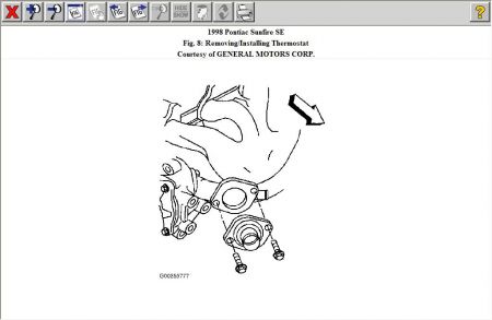

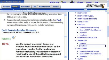

I was told that i needed to try to change my thermostat in my 98 sunfire. I am completely clueless as to how to do it. I have never tried to work on a car before and would love to be able to do this on my own without calling daddy. :) but i don't even know what it is or even looks like. Please help!
Jul 30, 2008 at 10:57 PM
  • 75,992 POSTS
Do no.5 see below
https://images.2carpros.com/forum/automotive_pictures/12900_thermostat_3.jpg
https://images.2carpros.com/forum/automotive_pictures/12900_thermostat2_1.jpg
