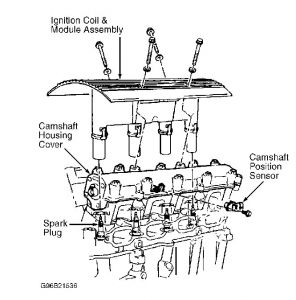

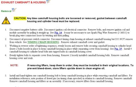

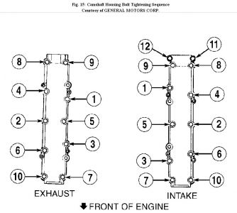

i need to know how to get the valve cover off of a 2.4 it is the exhaust cover one, so i can change the gasket i have all the bolts out of it but the side on the passenger dont seem like it wants to come up the other side comes up fine . i was wondering if i had to pull off the plate that is on the passenger side of the motor and there are some other bolts in there to get that valve cover off
thanks for any info
