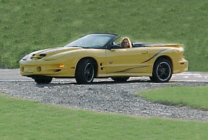

https://www.2carpros.com/forum/automotive_pictures/54438_2002TA_1.gif

P.S. Love the ride! (But I still yearn for the days of the older body styles and big block power houses!) :Twisted:
