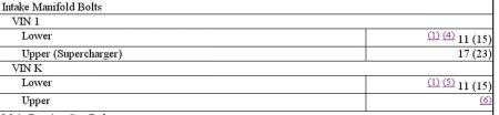

The cylinder head bolt and intake manifold bolts for sure have to be tightened in very specific pattern and to certain tightening specs. I haven't looked but many you need to tight down to one spec say 50 ft pounds,then re-tightend an additional 130 degress. and thenthen the center bolts only again another 30 degrees ....all in a particular order. This is important.
YOU MUST REPLACE THE HEAD BOLTS.
They are torque to yield and will not re-stretch.

I haven't overbored so I can't help there, but the specs will still hold true.
For $10 you can get a ton of info:
https://www.2carpros.com/articles/mitchell1eautorepair-car-repair-manuals
A donation here wouldn't hurt either. :mrgreen:
Anyways, here is what I have been referring to:
https://www.2carpros.com/forum/automotive_pictures/30961_gp_1.jpg
https://www.2carpros.com/forum/automotive_pictures/30961_gp1_1.jpg
https://www.2carpros.com/forum/automotive_pictures/30961_gp3_1.jpg
https://www.2carpros.com/forum/automotive_pictures/30961_gp2_1.jpg
https://www.2carpros.com/forum/automotive_pictures/30961_gp4_1.jpg
The numbers in parentheses are Newton-Meters, the numbers preceeding are in Foot- pounds.
