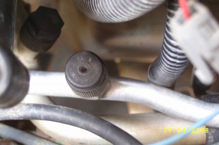

GFAIRES
I am looking to re-charge my A/C with commercial off-the-shelf refrigerant, but cannot find any identifying marks on the high and low pressure lines.
https://images.2carpros.com/forum/automotive_pictures/217958_AC_LINES_2.jpg

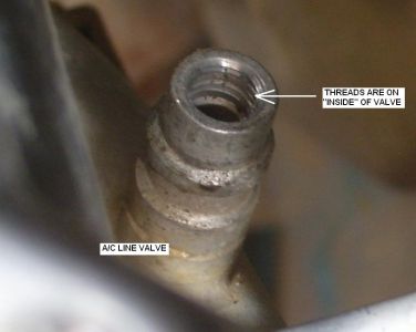

I have been told that the low pressure line is always the larger tube. Is this true? Also, this model (GTP) car is new to me and it does not seem to have the same type valves (for filling) that I am used to seeing. (air valve type) Are these a special type of valve
https://images.2carpros.com/forum/automotive_pictures/217958_AC_VALVE_2.jpg
and will commercial filler type refrigerants with the attached hose work?

MASTERTECHTIM
  • 4,750 POSTS
yes the low side is the fatter tube and you can buy refrigerant at parts store with a gauge and hose for cheap money.
