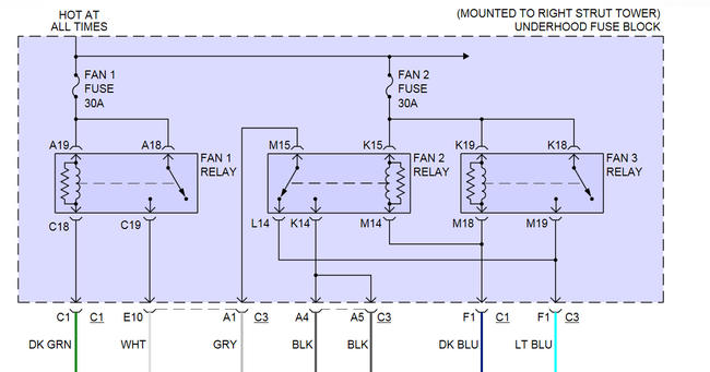

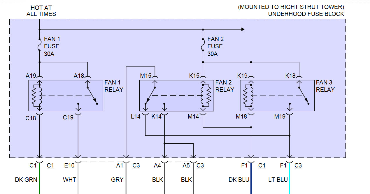

BUDDYWEISER86
Two days ago a squirrel tore into the wiring loom directly off of the fuse box near the firewall(passenger side). I spliced all wires back together, however am still seeing an overheating issue. Both 30amp fuses marked "Fan" in the under-hood fuse panel are good. Not 100% sure on the two fan relays in same fuse panel, HOWEVER, the radiator fan's DO work when the interior AC or heat are turned on. Also, the temp gauge in dash works, and shows a steady rise in temp, so I'm assuming from that that the temp sending unit is reporting actual temp to the ECU. Is there possibly a secondary temp sending unit elsewhere that triggers the radiator fans to turn on?
Sep 3, 2019 at 7:27 AM (Merged)
HMAC300
  • 48,601 POSTS
there may be two and you may have replaced the wrong one. see picsa nd make sure all wires have been properly repaired. it may be another issue as well. so have coolant system pressure checked.

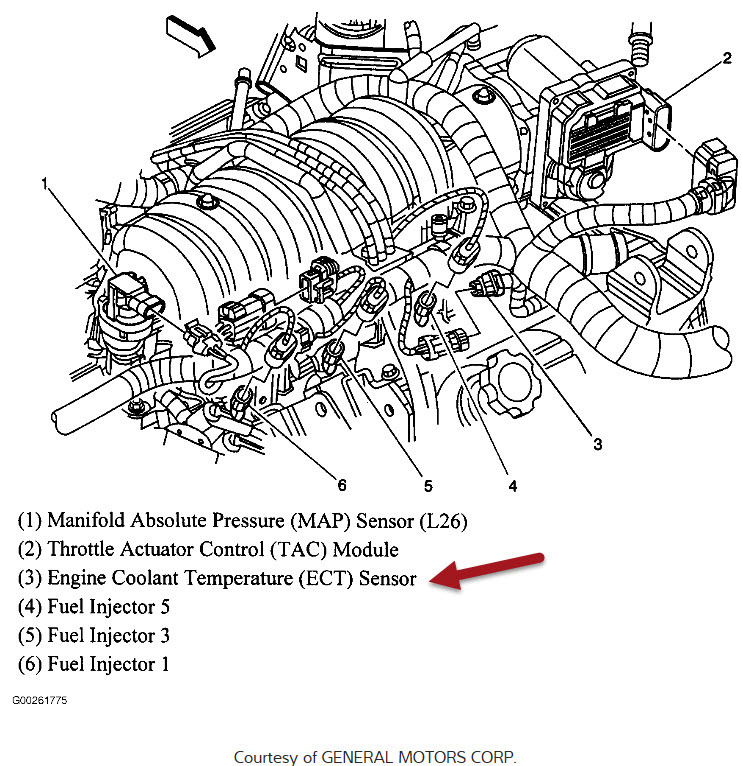

06GRNGP
I've replaced the water pump, coolant temp. sensor, thermostat, flushed the radiator, will radiator with 50/50 coolant to water. Still over heats. No noises or leaks. Gauge goes to hot within 2 miles or approx 10 minutes of running. A/C shuts off and car has turned off due to over heating. What could be the solution? I'm trying to prevent the costly trip to the dealership.

06GRNGP
Thanks for the options. I've actually fixed the problem. The thermostat that I replaced about a month ago, was defective. The thermostat would not open when 195 degrees was reached. Auto Zone is going to issue me a refund for this. I purchased a ACDelco from the local dealership and it works great.
It was suggested by a salesman at an auto parts to run the motor without the thermostat to verify that the thermostat was working or not. After I removed the thermostat, the engine ran lower than normal temps. Thank God that this problem is now resolved.
