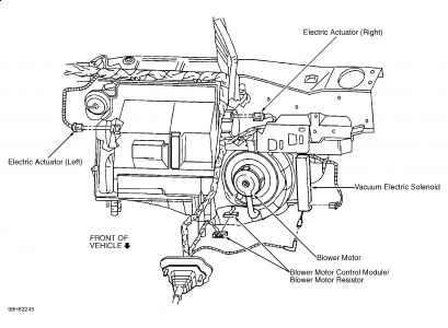

Where is blower motor located?
Tuesday, August 14th, 2018 AT 3:04 PM (Merged)
BLUELIGHTNIN6
  • 16,542 POSTS
Blower motor is located behind right side of dash, in heater-A/C module, pictured below..

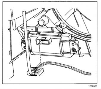

WRENCHTECH
  • 20,761 POSTS
According to my inforfmation, the only option for this car is an automatic syste. With an Autoo Temp control system, the blower speed is controlled by a blower speed control module. Both the power and ground are supplied by the module so that's a pretty strong indication that the module may be at fault.
Be sure to the the BATT MAIN 4 fuse in the underhood fuse box. It's a 30 amp.
The module will be located right next to the blower motor.
