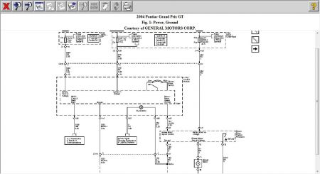

JDL
  • 16,098 POSTS
Check the fuse circuits, use a testlite, circuits should be hot. The bat main fuse is under the hood.
https://images.2carpros.com/forum/automotive_pictures/170934_04_pontiac_fuse_1.jpg
Aug 14, 2018 at 8:02 AM (Merged)

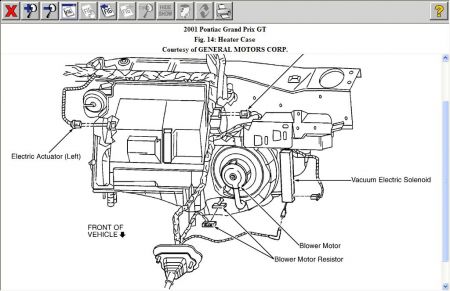

where is the resistor pack located? my blower doesn't work on any speed.
Aug 14, 2018 at 8:03 AM (Merged)
WATTS_AMAN
  • 15 POSTS
The resistor is located just forward of the blower motor its self. 3 screws only lossen the 2 forward ones, remove the aft one and slide towards you. If your Fan doesnt work on high I dont believe it would be the resistor. high goes straight to the motor relay and then to the blower motor. just suggesting it sounds like you may need a new blower motor.

JWERK24
  • 16 POSTS
where is the resister located on a 2001 g.p. 3.1liter?
Aug 14, 2018 at 8:04 AM (Merged)
  • 75,988 POSTS
Here you go
https://images.2carpros.com/forum/automotive_pictures/12900_blower_resistor_13.jpg
