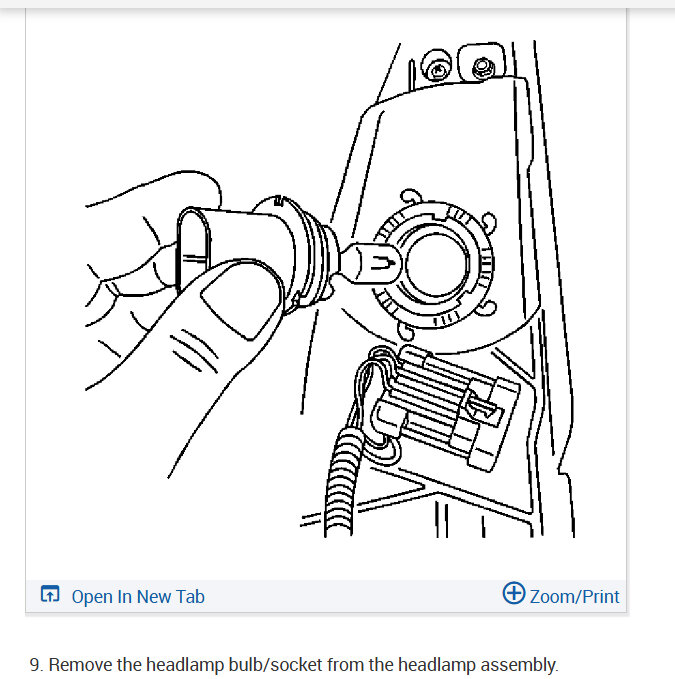

do I get at the headlight bulb plug on the drivers side?
2003 PONTIAC GRAND PRIX
TERRYMURPHY
Other Category problem
2003 Pontiac Grand Prix 74,000 miles
How in the world do I get at the headlight bulb plug on the drivers side of this car??...
I can see the plug where the unit goes into the lens, HOWEVER,, the is NO room to unscrew and unplug the connector to remove old bulb and install new bulb...how do I get at it?? Do I have to take the entire front end apart???

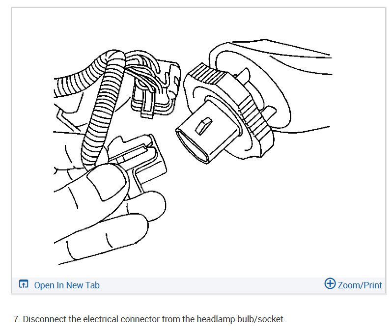

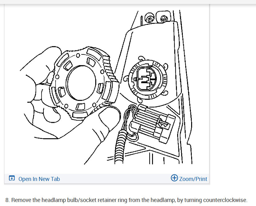

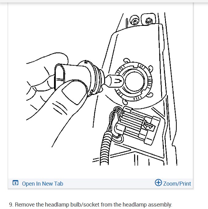

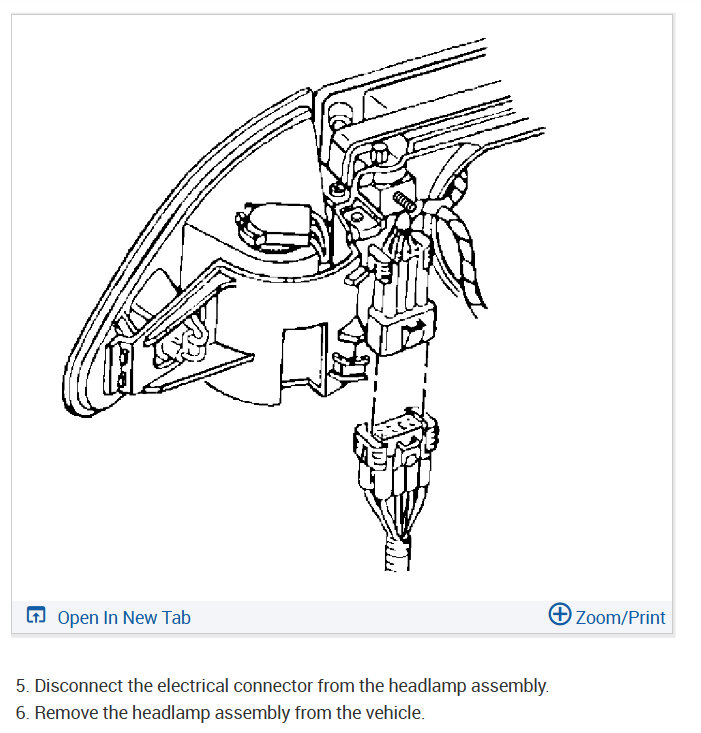

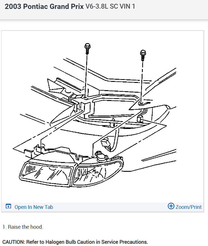

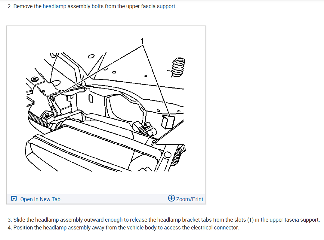

You have to pull the lens slightly out just enough to access it from the outside side ot the car.
Jan 1, 2008 at 3:35 AM
  • 55,111 POSTS
I agree with AMCGUY, here is how to change out the headlamp bulb. Check out the images (below). Let us know if you need anything else.
