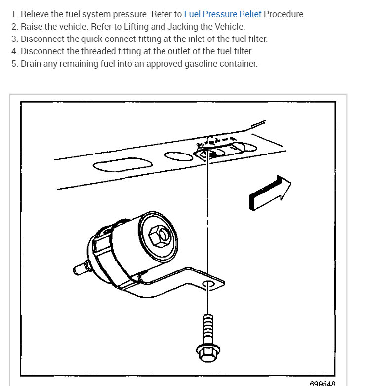

Why do my car hesitate at start of take off an all during drive it sputters an while going up hill it looses speed what I have tried gas an injector cleaner I have checked all my fluids an problem still persist there are no service engine lights or check engine soon lights on. What Do I do next?
Monday, April 19th, 2010 AT 2:00 PM
  • 75,992 POSTS

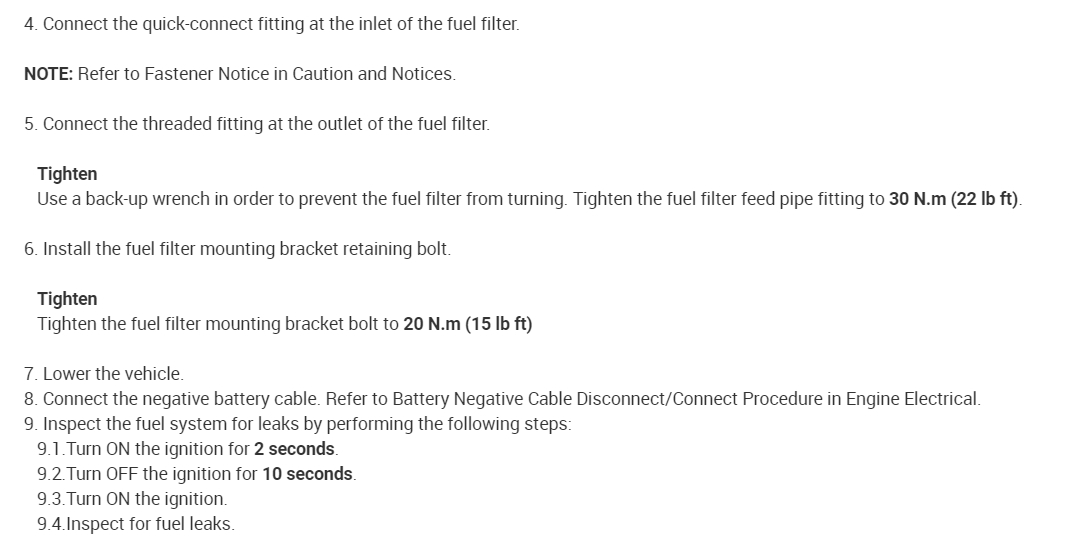

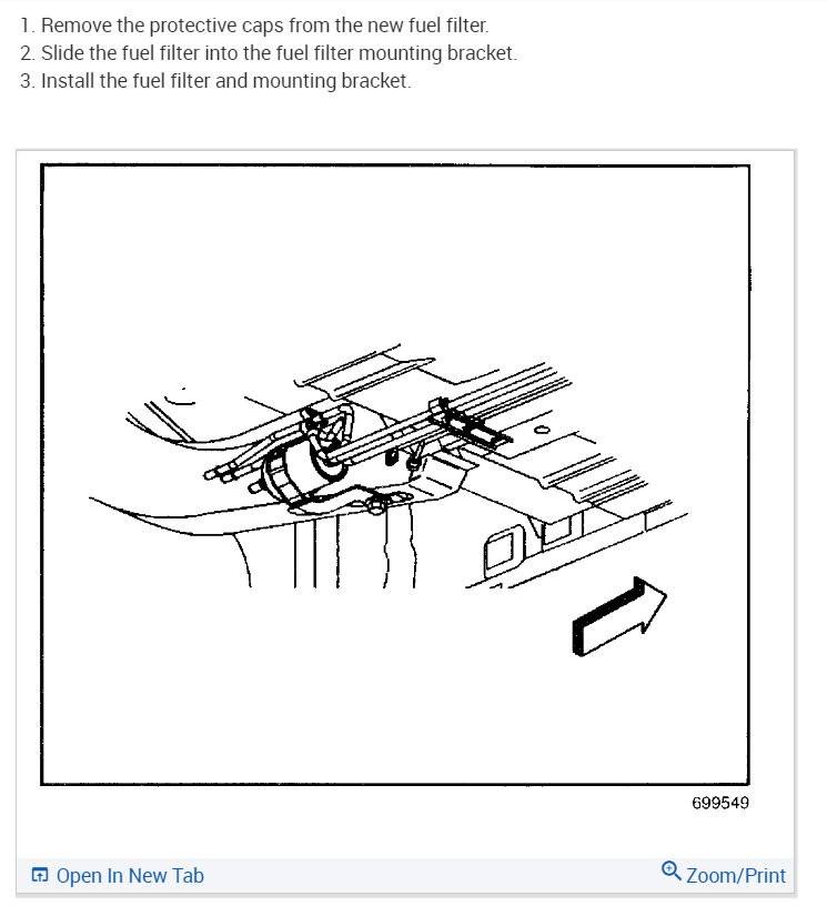

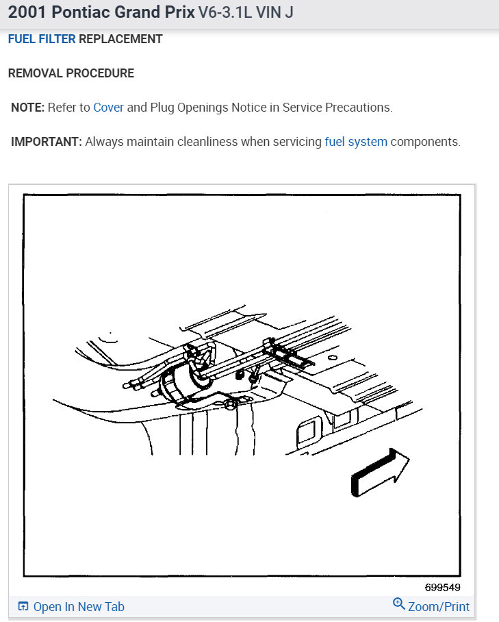

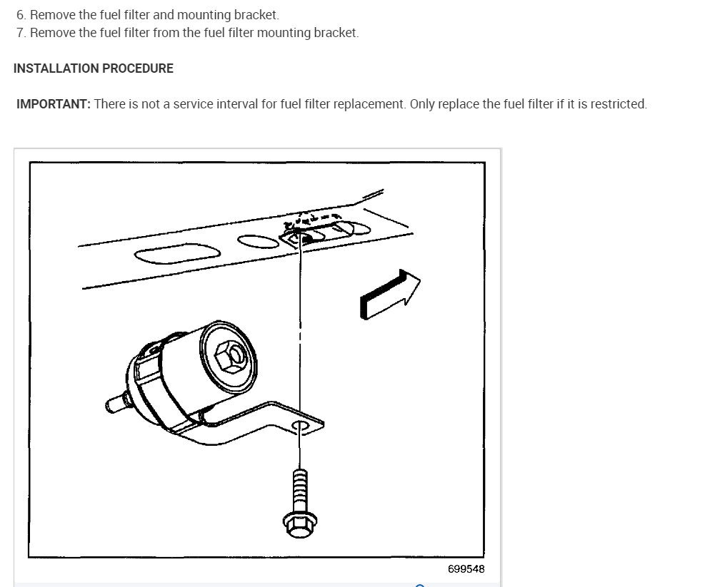

Yep, your fuel filter is clogged we just had this problem in the shop. Here is a guide to help walk you through the steps and instructions for your car below.
https://www.2carpros.com/articles/how-to-change-a-fuel-filter
Check out the images (Below). Please let us know how it goes
