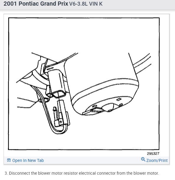

only level 5 blower fan worked ?
2001 PONTIAC GRAND PRIX
112,000 MILES • 6 CYL • FWD • AUTOMATIC
BBAILEY80

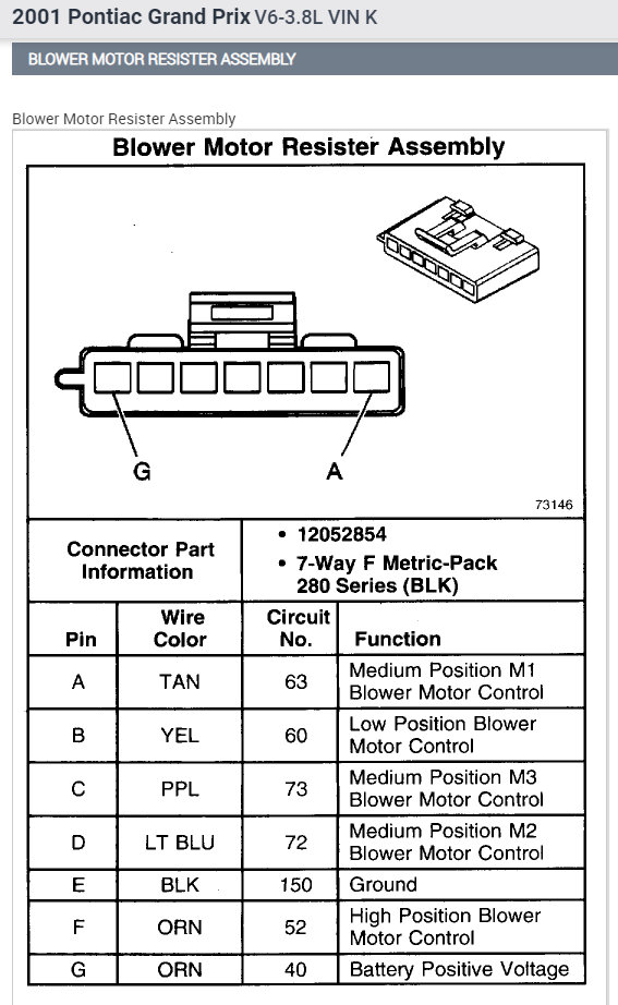

At first air would only kick on when fan was at level 5 (high) and by switching controls around from floor to mixed to top and back down, then i could switch to a lower level like 1 or 2. Then only level 5 fan worked and this morning fan did not work at all then on the drive to work it kicked back on like nothing was wrong?
Jul 28, 2008 at 12:39 PM
SQM
  • 6,383 POSTS

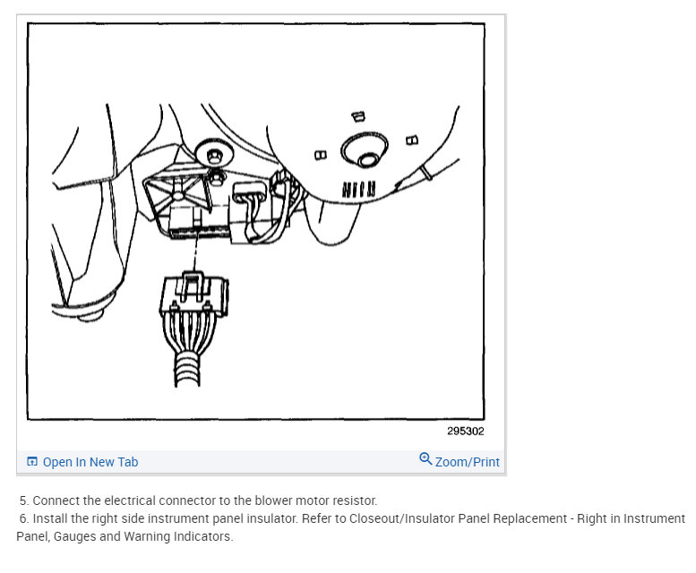

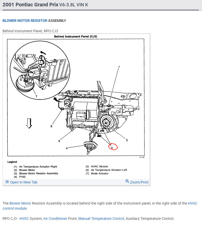

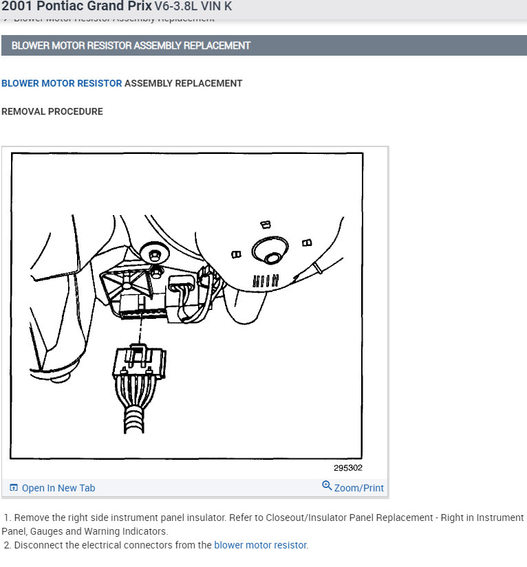

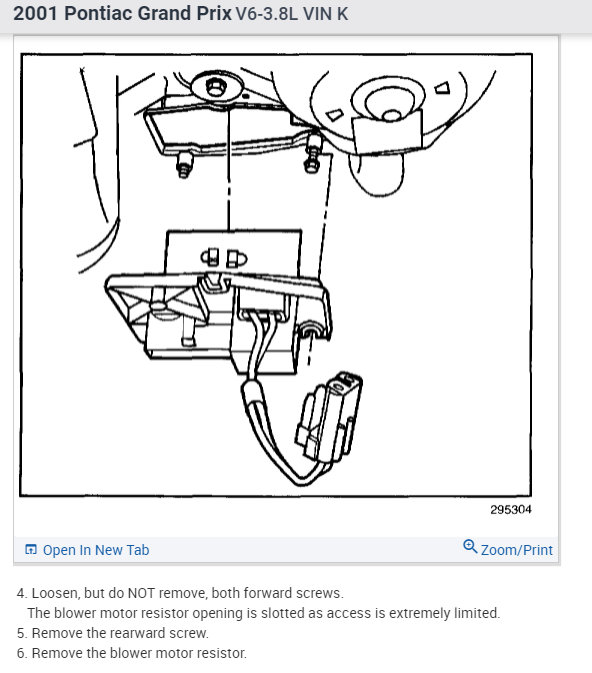

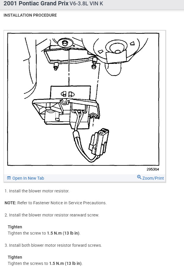

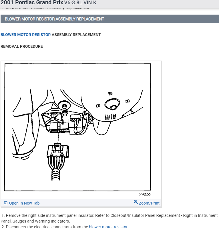

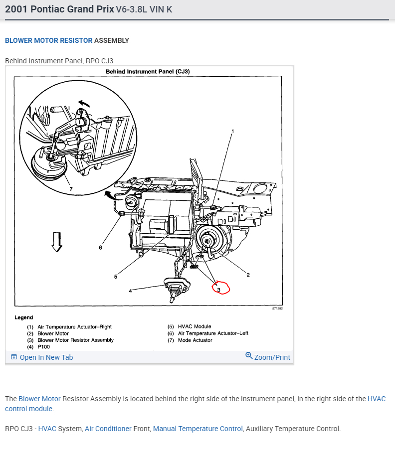

It sounds like the issue is with the blower motor resistor.
When the knob gets turned for the fan speed, it sends signal to the resistor and the fan speed changes.
Many times, the resistor will fail and will only blow air in one speed.
The blower motor resistor is located on the blower motor housing, under the passenger side dash.
https://www.2carpros.com/articles/blower-fan-motor-works-on-high-speed-only
