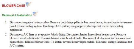

Hi, the fan squeals when running. Wanting to know how to replace it.

It is the heater / A/C blower fan

Thanks for the help.
