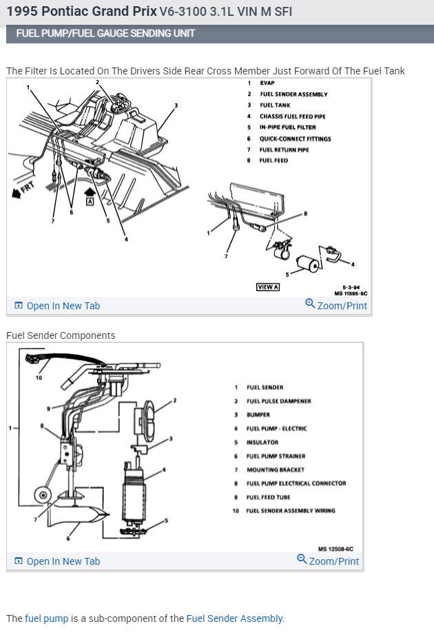

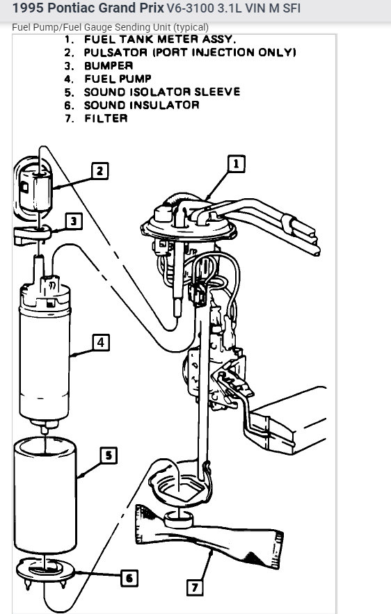

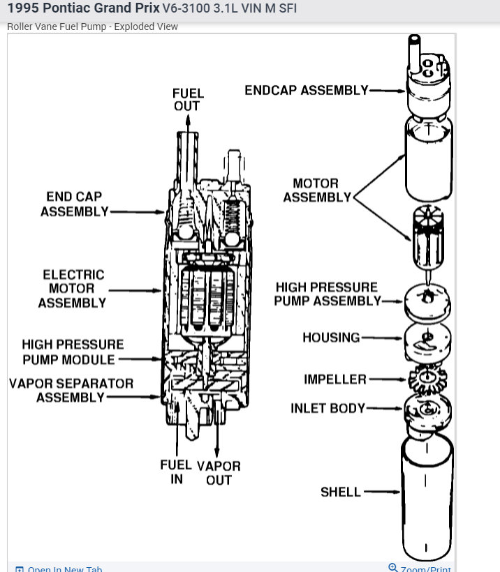

Where is the fuel pump located on car? How do you diagnois fuel pump failure? Car will not start after running out of gas, put about 5 gallons into tank and wont start.
Friday, February 19th, 2010 AT 3:58 PM
3 Replies
  • 75,992 POSTS
Its in the fuel tank

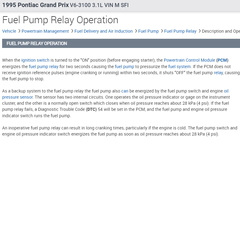

Do you hear the fuel pump come On for 2 seconds? if so check the fuel pressure if its within specs if not check fuel filter if its clogged if not-check the in tank pick-up sock if okay -then replace fuel pump.
See the guides below on testing the fuel pump
The diagrams below contain pictures and instructions on fuel pump replacement

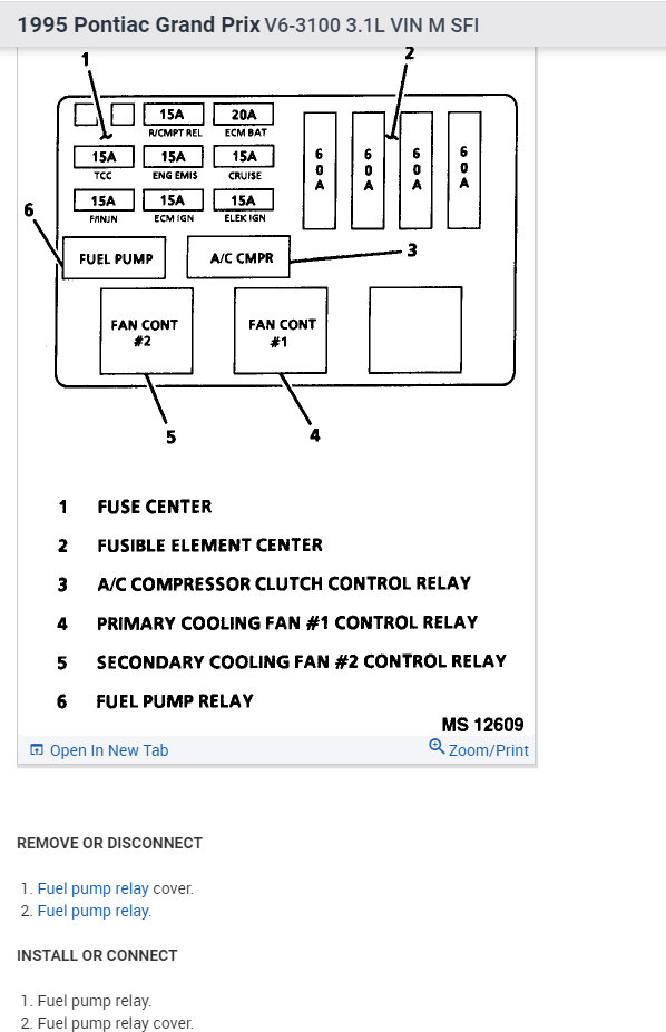

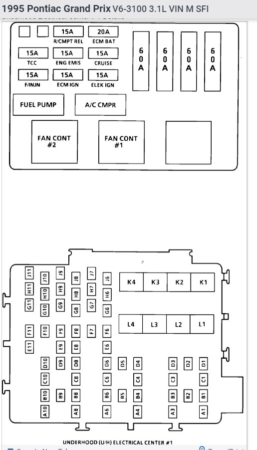

MATTYGW
A fuse blown was the problem thanks
+1
Saturday, March 20th, 2021 AT 7:32 PM
SQM
  • 6,383 POSTS

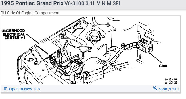

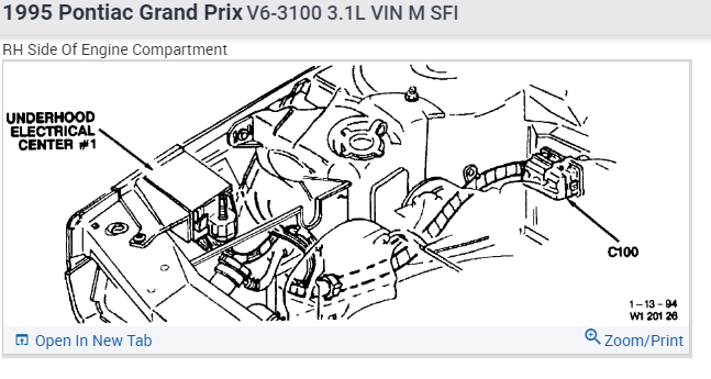

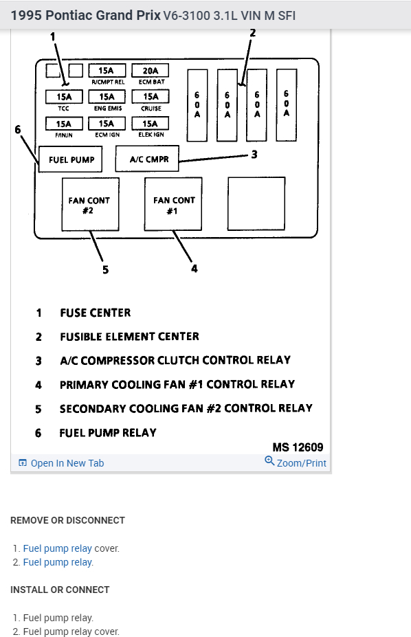

The fuel pump relay is located in the under-hood fuse box # 1.

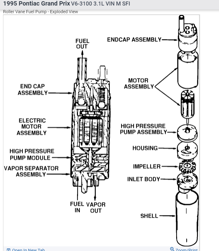

I have attached the fuel pump replacement procedure for anyone else who might be looking to replace the fuel pump.
