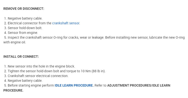

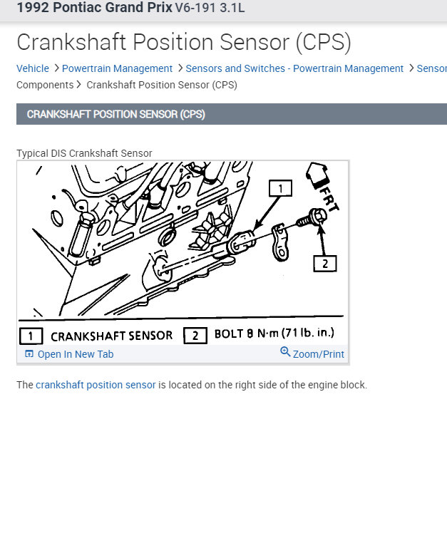

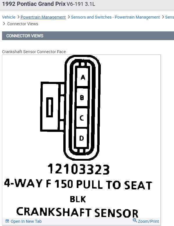

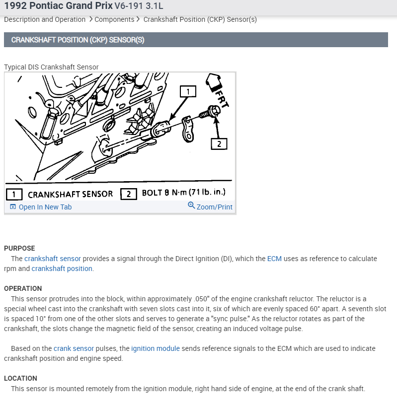

It sounds like you could have a faulty crankshaft position sensor.
Over time with heat and vibrations from the engine the crank sensor can lose its internal calibration. Which will cause it to send error signal to the ECU. That can trigger an engine shut down.
When a crank sensor fails it can shut the engine down as you are driving down the road.
After the shut down the engine may or may not start back up. Sometimes it will start up at the beginning but then it will stop working completely.
