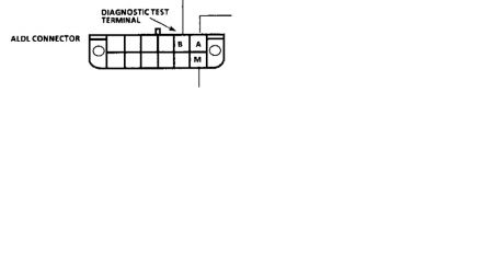

To me, it sounds like an idle air problem. Clean the throttle-body and check the idle air control system. You should be able to access mil codes, yourself. You place a jumper wire between the A & B terminals at the datalink connector. Then, turn the key till the dash lites come on, no further. The mil on the dash starts flashing, you count the flashes to get the codes. Your looking for two digit codes. As an example, a code 12 is one flash followed by a slight pause then two quick flashes. The picture below is just to show location of terminals A & B.
https://www.2carpros.com/forum/automotive_pictures/512072_aldl_4.jpg
