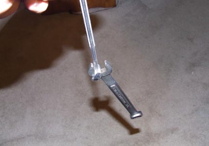

I am having a very hard time replacing the serpantine belt after installing a new alternator. Can't seem to get to the tension spring, please help.

1 of 2 ways, I use two boxed end wrenches and put them together on the pulley nut, this will give the leverage you need...
https://www.2carpros.com/forum/automotive_pictures/62217_wrenches_3.jpg
