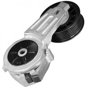

i would like to know how to relieve the tension on the belt to remove the water pump

There is an automatic tensionier that rides on a pivot. You will either need a wrench or ratchet based on which one you have. Place the ratchet in the slot made for it and turn the tensionier in the direction to loosten the belt. Remove the belt and release tension. (watch your fingers) Here is a picture of the tensionier. Also, if you need belt routing information, refer to the belt routing diagrams site on this page.
https://images.2carpros.com/forum/automotive_pictures/249084_5_42.jpg
Let me know if this helps or if you have other questions. Joe

thanx! got it off and feel a little dumb for not seeing it in the first place. thanx again
