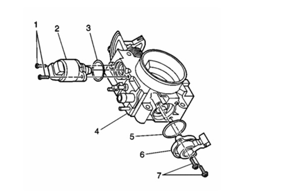

how do i clean the throttle-body and air control??
Jul 6, 2020 at 7:15 PM (Merged)
JDL
  • CERTIFIED EXPERT
  • 16,098 POSTS
Remove the throttle-body to clean. Some of the national brand autostores used to check trouble codes for free. There should be some codes.
In the picture, #2 should be the iac.

thanks i will check codes and clean air intake and let you know the outcome.

I cleaned the throttle body and the idle air control it running alot better, but still sluggish when i stop at a light with foot on brake it idles rough.. like it wants to cut off..
