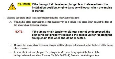

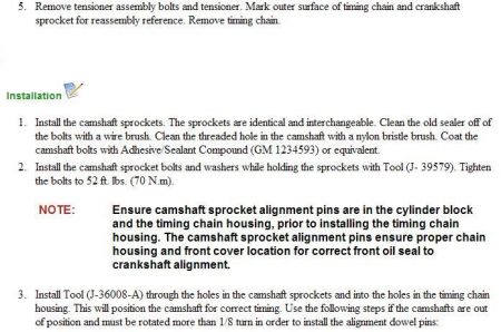

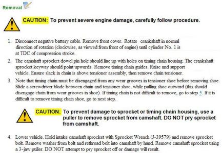

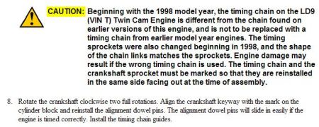

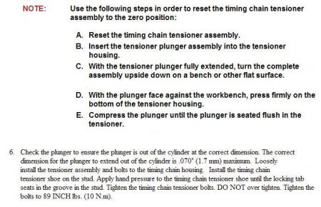

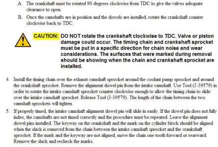

How do I set the timing chain on my 1999 Pontiac Grand Am the engine size is 2.4.

Below are the proper steps to replacing your vehicle's timing chain..
