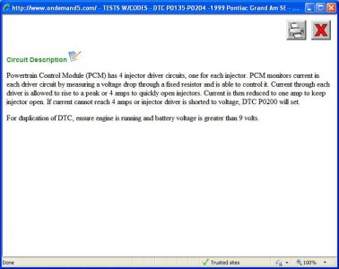

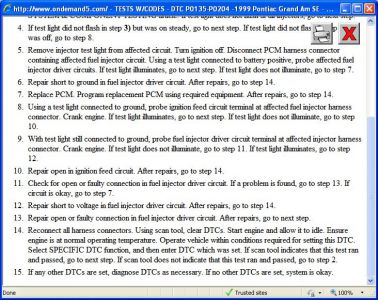

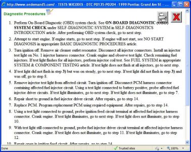

Have 1999 Pontiac Grand Am was driving kids to school and all at once car started running rough would harldy idle, check engine light came on, borrowed friends code reader, it came up with code 200 injector lline breakage, could you help with possible ansewer?
Monday, July 6th, 2020 AT 7:04 PM (Merged)
SATURNTECH9
  • 30,869 POSTS
https://www.2carpros.com/forum/automotive_pictures/416332_1999_pontiac_grand_am_code_p0200_part1_1.jpg
https://www.2carpros.com/forum/automotive_pictures/416332_1999_pontiac_grand_am_code_p0200_part2_1.jpg
https://www.2carpros.com/forum/automotive_pictures/416332_1999_pontiac_grand_am_code_p0200_part3_1.jpg
There is the trouble tree for the code p0200 give that a try and see what you can find.
