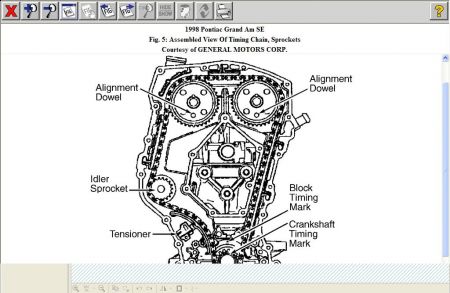

we recently have rebuilt a 2.4 engine and were wondering about how to install the timing chain and set the timing on it.

Put the engine no.1 piston on compression stroke/TDC align crank pulley to 0/TDC markings then set all the markings as you see below
https://www.2carpros.com/forum/automotive_pictures/12900_timing_chain_7.jpg

Would u be able to give me that diagram again so I can see the bottom of it please and thank u

There's nothing to see below that-just put the crank gear dot in position at 12 O clock as you see it-You'll be okay-
