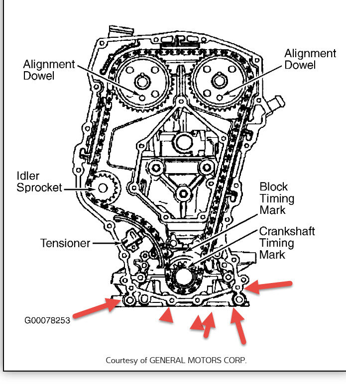

Removing the Housing to the timing chain it will not come off
KIMBERLY ADAMS
  • 1999 PONTIAC GRAND AM
  • 2.4L
  • 150,000 MILES
I am trying to replace the housing cover to the timing chain. All bolts are out but it will not come off. Can you please tell me what to do to get it off.

See picture make sure all bolts are out and on bottom and make sure no bolts in oil pan are holding cover which they probably are.
