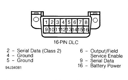

Can you please show a picture of where the computer is located for scanning of codes in a 1995 Pontiac Grand Am.
Feb 21, 2009 at 12:33 PM
OBXAUTOMEDIC
  • 3,711 POSTS
Hello, The connection is located under the driver dash and looks like this.....
https://images.2carpros.com/forum/automotive_pictures/188069_95grnamdtcconnection_1.jpg
This guide can help https://www.2carpros.com/articles/buick-cadillac-chevy-gmc-oldsmobile-pontiac-gm-1983-1995-obd1-code-definitions-and-retrieval-method Please run down this guide and report back.

I have a ob1 connector but everyone I took it to that had the OB1 tester could not get the code from the computer, it kept saying "connect to the computer failed". What could cause this and how would I fix it? Is there another way to get the code from the computer via OB1 connector?
Dec 7, 2020 at 8:25 AM (Merged)
HMAC300
  • 48,601 POSTS
a paper clip corssed between A & B wil get it but if there is a connection problem that may be why or a blown fuse. turn key on and count flashes of service light it will flash three times for each flash lie 1 then 2 is a codes 12 which is normal.
