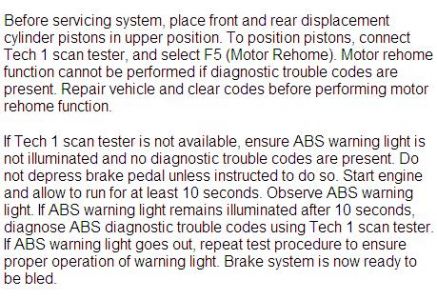

I can't get fluid to bleed out of the rear bleeder valve. I replaced the rear drums, pads, springs, cylinders, and the two little brake lines that run to the cylinders. Around two days prior I had replaced the front rotors, calipers, and pads. I had no issues bleeding the front brakes, but now that I have replaced the rear as described above, I can't get fluid to bleed out of the rear bleeder valves. I have ABS brakes and don't know if I might need some special tool to help the bleeding process.

Welcome to the forum. This probably isn't what you want to hear. To begin, Grand Am GT. If there are any abs codes, you may have to deal with that before you can do anything.
https://images.2carpros.com/forum/automotive_pictures/170934_abs_brakes_1.jpg
