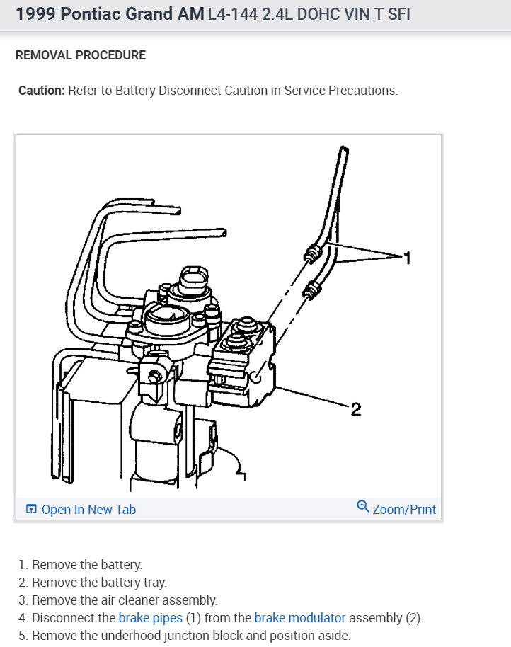

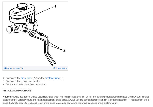

I need a copy of a diagram for the entire braking system from the master cylinder to the wheels
Apr 22, 2010 at 4:36 AM
✓Experienced Mechanic
110,240 POSTS
I do have a schematic, I can tell you. From the master cylinder, two lines go to the ABS module. From there, you have lines that go to the proportioning valve. Then you have one to each front tire, one to each rear wheel cylinder (or caliper if you have 4 wheel disc). Here is what we have in the diagrams. Check out the diagrams (Below). Please let us know if you need anything else to get the problem fixed.

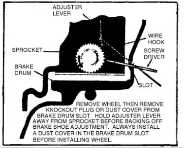

I am trying to change the rear brake pads. The pads are into to the drum and I cannot remove the drum. How do I loosen the self adjusting screw when there is no hole or port to access the screw?
Oct 22, 2018 at 10:08 AM
(Merged)
FACTORYJACK
4,159 POSTS
Here is a picture of what I gathered off of ALLDATA. There should be a knockout stamped in the drum. The only other option is grinding/shearing off the heads of the holddown pins, or prying until the holdown spring washers pull through.
