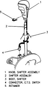

Trying to get console out to change heater core need help removing shifter handle

CENTER CONSOLE REMOVAL
Apply the parking brake, and place blocks of wood on the sides of the drive wheels to prevent the vehicle from moving.
Move the shift lever to the neutral position.
Disconnect the negative battery cable for safety purposes.
Using a suitable tool, remove the shift knob retainer from the slot in the lower portion of the knob. If equipped, unplug the electrical connector at the base of the shifter, under the boot, and remove the shift knob.
https://www.2carpros.com/forum/automotive_pictures/261618_0900c1528025fbca_1.jpg
Remove the console trim plate by pulling upward gently to disengage the retaining clips. Unplug the electrical connectors and set the trim plate aside.
Remove the fasteners that retain the console.
Carefully lift the console enough to access the electrical connections. Unplug the electrical connections, and remove the console from the vehicle.
