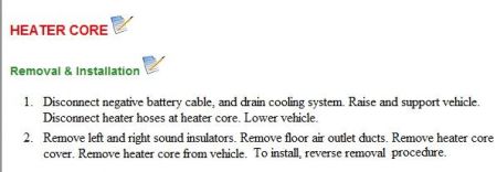

1993 Pontiac Grand Am 4 cyl Two Wheel Drive 99 miles
WHERE IS THE HEATER CORE AND HOW DO YOU GET IT OUT, i'VE CHANGE ALOT IN MY DAY BUT I NEVER SEEN ONE UNDER THE FIRE WALL WHAT AHECK A PLACE TO PUT IT

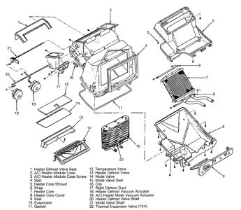

i NEED A DIRAGRAIM DRAWING TO HELP WITH THIS
THANK YOU

https://www.2carpros.com/forum/automotive_pictures/261618_Noname_2144.jpg
https://www.2carpros.com/forum/automotive_pictures/261618_Noname2_694.jpg
