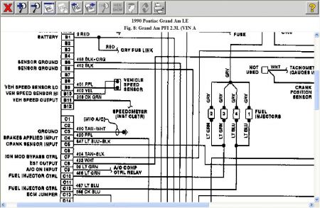

If you got power at 1/4 injector harness gray wire and its not pulsing-you have a problem with the injector driver in the computer-see below

Here's the latest. Pulled out my GM service manual and went through series of tests. At three pin connector from ecm test light blinks for both blue and green wires when grounded to gray. Checked resistance of injectors (should be under 3 ohms). One was 2.7 and other was 1.3, so should be okay. Grounded gray wire with test at each injector connector. Test light blinked on #4, but not on # 1. While checking for electrical pulse to # 1 connector, noticed engine ran smoother and # 4 was now firing (exhaust manifold getting hot). When I re-connected # 1 injector connector, both cylinders now misfired. Other series of tests tended to point to faulty ecm. Maybe a short to # 1? Why would connecting # 1 cause # 4 to stop firing, but # 4 fine with # 1 disconnected? This problem has made me lose sleep!

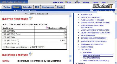

Sounds as though between injector 1/4 its dragging down the other-

That may be true, but if they are connected in parallel (which I assume they are) then the equivalent resistance would be 2 ohms, which is what is expected as per your chart. I am going to check for a short or discontinuity in injector # 1 connector, but I still don't see how that would affect # 4 to the point of misfiring.

In a parallel circuit the resistances are always less than what they are-
Disconnect the injector harness and the PCM connector and check the wiring for short and open-no wirng problem its between the injector and computer

No shorts or opens. Swapped out #1 & #2 injectors. Now #2 & #3 aren't firing. Think I found the problem. According to the manual, as long as the injector had no more than 3 ohms resistance but not zero, it should be okay. All other injectors have about 2.6 ohms, and the 'bad' one has 1.5. I wouldn't think too much current would make it now fire, but that seems to be the case. I am going to pick up a new injector and pray for the best!
